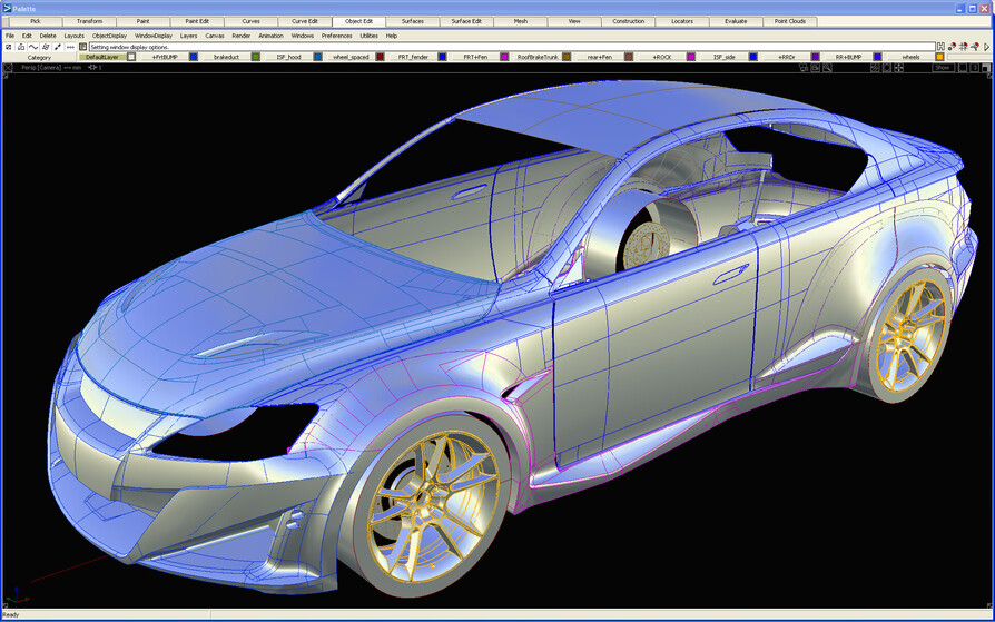

I’m interested in finding out more about the software commonly used in the automotive design industry. As far as I’m aware, Alias Studio is by far the most common software used in this industry.
  • How true is this and what other software is commonly used?
  • Do poly modeling programs play any significant part in the pre-vis stage or are they used by companies in the advertising stage or when producing photorealistic renders?
  • Or is it entirely a nurbs field?
  • When it comes to the manufacturing stage, are the parts usually re-modeled using engineering programs such as Pro-E?
Looking forward to some good knowledge :wink:
Hi, ill try to answer your questions, Im working as Class-A surfacer in automotive industry, particular in WV concern, so my knowledge comes from concern standarts
Alias is widely used, so as Icem Surf and even Catia surfacing mods like generative shape design or ISD (icem shape design)
for visualisation 3dmax, alias or any other kind of quality rendering software, physical based unbiased softwares are giving great results too
According to low control over surface quality, they are not much used, best renders and vizus are from class-a surfaces
Mainly Bezier to be precise (base part of nurbs surfaces)
Engineering stuff like plates and whole construction, electric cables and so on are done in catia, visible surfaces (class-a) are never re-modeled, you dont want to degrade their quality.

Khalid was pretty spot on, the only bit I’ll add is I’ve heard in some studios they will work in Maya using a hybrid of Polys/Sub-D’s/Nurbs for quickly fleshing out concepts in 3D form before jumping into more detailed surfacing. Polys in general are more flexible and more forgiving, and Maya has pretty clean data exchange with Alias, so I’ve heard it being used though haven’t seen it first hand.
As far as what employment opportunities their are? It’s pretty tight and you won’t find someone willing to hire an auto designer based only around 3D. The non-NURBS techniques out there seem to just be a fill in for the designers to quickly sketch 3D ideas - there is still an expectation for you to be a full on car designer from sketching forward before that. Other then that film or ads is probably the main area, and even then that’s a lot more about being able to not just model but render and animate as well.
there is hope…
there is alot to be said about polys.
Yes advertising for sure. google cgcars
i have heard that in Europe some OEMs are using polys early in the design process as you have mentioned. equivalent to sketching. still has to be NURBS at the end though. its a lot easier to reverse engineer a poly mesh.
I particularly hear about it for Interiors. look for the “bentled” channel on youtube. “mudbox_to_alias” or “ip mud”
we do a workshop converting polygons to NURBS. Basically a techniques workshop for designers.

What are the reasons for poly modeled vehicles to be used for film and ads instead of NURBS?
  • often the cad data is not available outside the OEM. its alot easier to cheat or recreate the look of the vehicle in poly’s . for film and motion, close enough is good enough. you can get away with a lot with fast camera edits and motion blur.
  • Poly’s are a level of security for distributing files, This protects the Intellectual property of the Design.
-Level of detail for mesh density and rendering times that come into effect.
you might be able to find examples on the Chrysler website. they use to have a public area that you could down load their Vehicle files.
Quicker and easier to work with. A lot of times, NURBS will also NOT translate in a friendly fashion to polygons. The nature of taking a mathmatically perfect curve and trying to break it into linear segments means you’ll wind up with gaps, or super heavy meshes when intersecting parts meet.
When building natively with polys or Sub D’s, you can be a lot sloppier in getting the overall shape without worrying as much about the perfection of your surfaces, because it will never be seen in real life. Have you ever watched a CGI scene and said “hey that car looks like the reflection on the rear door doesn’t quite line up”? VS have you ever gone to a car show and seen a restored car and say “ew…that door doesn’t line up”.
Plus polys only need to represent the visible surfaces. CAD data needs to represent all of the internal parts that hold everything together which when converted directly winds up being MUCH more data.
I hear people say this. I’ve never modeled a car in both poly and NURBS so I can’t say. Have you? I just can’t believe that it would be quicker pushing lots of vertices around rather than joining curves. Surely a dedicated tool such as Alias would be faster.
Why does it need to be translated? I hear it can be easier if texturing (uv mapping). I’ve never experienced any gaps when translating NURBS to polys. From what I gathered it is an issue if animating/deforming the model.
I have, and it generally is faster to do polys (especially if it’s your job) than it is to do it with Nurbs, because it is by nature less accurate. The other reason is NURBS modelling (especially for something like a car) requires a lot of understanding of surfacing strategy. With polygons, if you don’t like a part of a model you can delete a chunk off, add some new polys, and radically change the impact of the smoothed surfaces when you’re done.

You always need to translate between NURBS->Polys, the question ends up being “What happens when I do this”. Some software is very good about it, and some software (especially some of the more popular animation packages like Softimage or 3DS) tend to not digest the geometry as well.
But to get a good looking poly model it also involves a good understanding of surfacing strategy. The image you posted is a low-poly gaming model but when modeling a higher detailed, high poly car, the larger number of vertices can become very awkward.
This is just an image I googled but it shows what I mean. And this isn’t a very complex car neither.
Trying to keep curves looking good involves lining up all those vertices in the correct position. Then if an alteration needs to be made it has to be all done again …and again …(can you tell I’m bored of moving vertices :slight_smile:). How can that be easier than applying sweeps/lofts?
Well the example I provided was actually a Sub-D base mesh, but the point is relevant to your example as well.
A model like the one you show is typically taken and then has a “Smooth” function thrown on it (creating more geometry from the simplified mesh). In poly modelling, I can take a row of edges and extrude it rather quickly. No matter what I do, when I apply that “smooth” function to a continuous mesh, I’m going to get a reasonable looking shape.
With NURBS, you can build your base surfaces fairly quickly, but when you start looking at some complex transitions where you have multiple surfaces coming together, it becomes rather tricky to get it right and do it in a way that is managable. You need to trim away, align new curves, and hope that everything comes together right.
Both can be time consuming, but the advantage of polys in a case like that is that if you want to make a point where 5 things intersect, you can do so rather quickly and don’t need to worry about breaking tangency or continuity, as soon as you smooth your object - bam, continuity is back.
If you look on CGcars or some of these forums you can see some of the works these guys bang out. I think if anything it has to do with the fact that it’s a lot easier to figure out poly modelling since theres only 3 real elements (vertex, edge, and a face). Theres no real worrying about things like curvature continuity, adding fillets (the smooth will do it automatically if the edges are lined up right) etc.
With that said, I do know people who focused specifically on getting good at modelling cars in NURBS, and they can do it pretty fast as well, albiet not to automotive standards.
