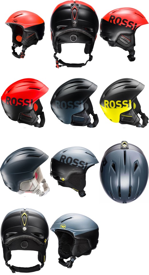

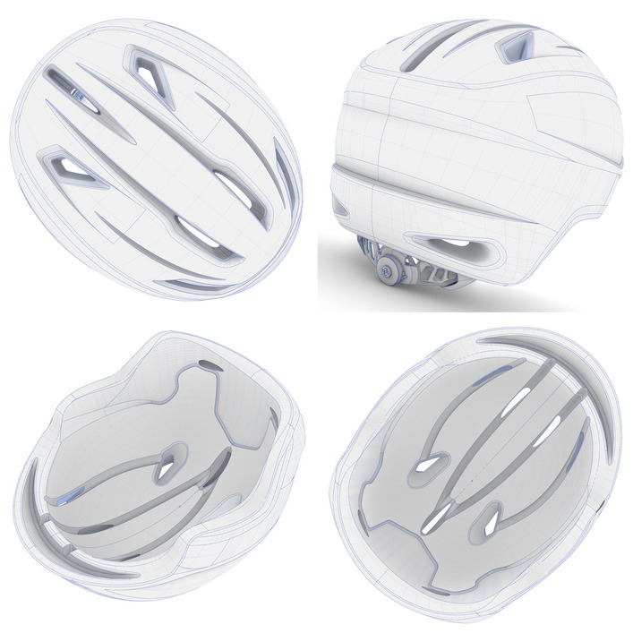

Not exactly the latest, snow sports production work from 2012. Ski and snowboard crossover helmet. Polycarbonate thermoformed in-molded shell with BOA adjustment system.
This was the evolution of the previous model helmet that followed a clay-to-digital workflow. Clay sculpting of the prototype helmet shapes had been an integral part of sports helmet development. Although surfacing tools had been in place for a decade at least, sports companies did not trust them 100% yet, especially for helmets where very subtle variations are fretted over, akin to phrenology. Confidence in the fidelity of the surfaces throughout the previous hybrid workflow, digital-to-clay-to-scan-back-to-digital, allowed us to set this following model up differently.
Lightweight foam models were cut and others 3D printed to be fit-tested and matched with goggles during the confirmation stages.

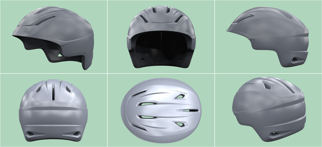

This helmet model development was digitally based from the start, specifically because of the tools and workflow made possible by Rhino.

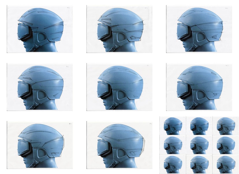

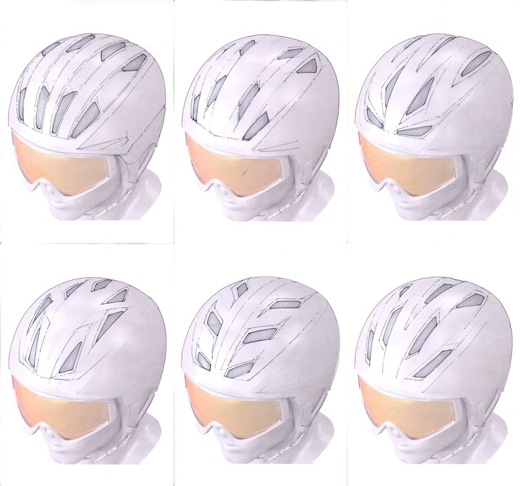

The overall volume was determined and the sketch work began. This method was to sketch on faded printouts and allow for re-importation, 1:1 scaling of the features.
One developed personal approach is the draw construction lines, a project-specific grid on the 3D, and use that as an assist for accurate 3D vent or feature sketching in non-planar views. The orthographic top and side views do not communicate an accurate impression due to curvature and perspective.

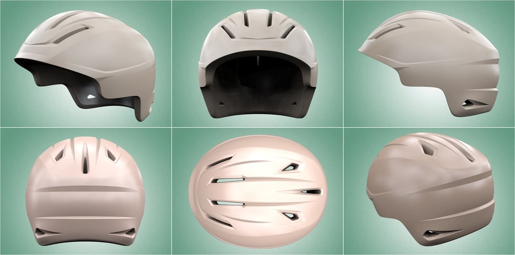

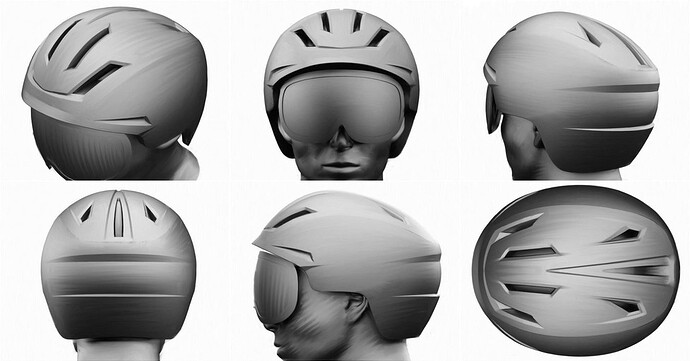

Once a vent design was selected, roughed into the CAD shape and then the 3D renders painted over to maintain a sketch mindset without sweating the finer surface details during review.

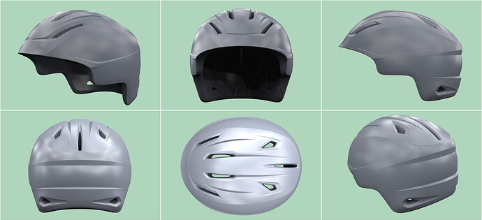

On to a more detailed 3D and renders, keeping the clay look initially.

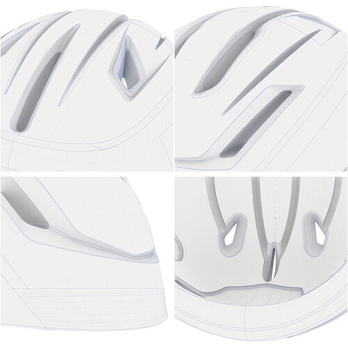

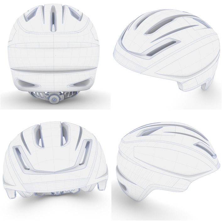

And then the deep dive into the production surfacing, as minimal as possible given the details and transitions, molding considerations, venting and hardware, and fit system integration. Finally, after the first tooling test confirmation, the creation of different sizes/headforms maintaining foam thicknesses and fixed hardware constraints.

Nice. Love seeing process. Has the process flow changed since then? Do you ever go back to clay?
I love this traditional workflow of sketching over printouts. And overall project process is great. Thank you for sharing
Very nice. Thanks for sharing all of the iterations and refinement.
One of my very first professional ID projects was a snow sports helmet. I also was learning Pro/D at the same time. Although we had a few ‘checks’ with the real world mainly for liner fit, our first look at what I had surfaced revealed that I had made a XXXL size. This was manifest in a very expensive (at the time) SLA model. I worked for free for a week or two.
Having the reference surfaces to start with (and I assume composite scans of competitors also overlaid) must have been a great help. Nice to see this whole process in detail. Cheers

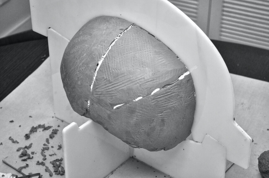

I loved the process of working with clay. Sadly this was the end of that era for helmets for me. Direct 3D modeling was proven and the ability to print a proof across the world on a 3D printer was too convenient and streamlined the process.

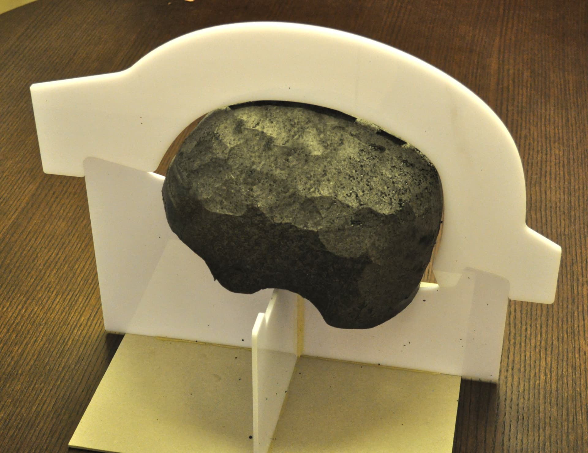

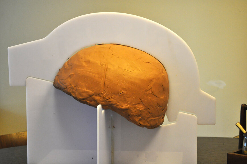

At the end of the clay process, the previous helmet, I had the controls and back and forth to maintain thickness, orientation, shape verification with templates inside and outside.
Some CNC cut templates that registered the headform ( donor known helmet ) and guided a CAD shape model into clay. Some rough starting point images below.
The thickness of the foam was precisely monitored throughout by this stage of helmet manufacturing, all of the testing standards lines, goggle fit and venting are built in CAD and drove the shaping, including factoring in the strap anchors, etc. There were a lot more uncertainties 10 - 15 years ago that would have to be fixed by the factories after testing, which often conflicted with the vision.
