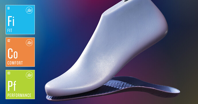

Does anyone have any resources or link to companies that supply Sneaker Last? I’m more of a hands on person and I would like to actually design around one. BTW I’m a newbie here so please excuse this question if it seems stupid :smiley:

I’m not sure who you’ve already found, but you can always try Jones and Vining, one of the largest lastmakers.
I’m not sure what you could get from them without $$$, but if you are student, maybe they could send you some old lasts to check out.
