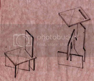

Regarding the posted sketch – totally gorgeous, and very elegant solution. As a former engineer, though, I gotta point out the structural issue inherent in the design. Casting a flat, thin slab in concrete is generally a bad idea unless it’s reinforced. Unless you’re expecting the DIYer to purchase, bend and place rebar in the mold before pouring, you’ll have cracking and probably failure on the seat slab pretty quickly.
It might help to arch the bottom?
hitch, thanks for the input. The last ‘sketch’ I posted has the thickness at 1.5" but I will do a bit more research on the cement itself to see what should be done. The image really does not show the scale of the chair, which is 18" wide/deep with an 18" seat height.
I have seen other pieces of furniture (tables, countertops) that appeared to be of similar thickness, but they very well could have been reinforced in some way. I would prefer to keep the cross section thin, but adding ribbing may bring the mold into a more complex form than can be made with cardboard, and asking the end user to add rebar is too much.
Perhaps I can find a better (i.e. DIY-type) of reinforcement that is both inexpensive and requires minimal to no tools. One Idea that comes to mind is adding some steel pipe and elbow joints using off the shelf parts from the hardware store, but ultimately, I may need to re-think either the thickness or overall shape to keep the chair as simple as possible.
if the span of the seat is going to be a problem, could you not do a slatted seat, made just with steel rods or flats, rather than using the steel to reinforce the concrete? (you will have to worry about joints, tho) embedded reinforcement needs to be a minimum of 50mm away from the outer atmosphere which means that the seat slab would have to be at least 100mm thick (reinforcement in the middle, and 50mm of concrete on either side) this is for buildings tho, i dont know whether different rules would apply for simple garden furniture. the concrete uprights on your chair wouldnt be a problem as concrete is good in compression
Well, the thing with concrete is, making it thicker won’t necessarily help – its strength to weight ratio in tension is abysmal, which is why almost all large concrete structures have steel reinforcement (and why very few of them are slab shaped). It does have two great advantages though: it’s very strong in compression (as bluegrrl pointed out) and it can be molded in any shape.
I think if you had an angled or arched connection between the legs and the seat, that would avoid a lot of tension cracking problems in the seat slab – check out Gaudi’s columns on the Sagrada Familia, or even Gothic cathedral arches and buttresses. Great examples of turning a structural necessity into something beautiful. Just my own prejudice…

well here’s my sketch - not particularly attractive, but made of flat interlocking pieces. the seat is supported by a cross underneath it - don’t know if it will work or not - but if it does, you wouldnt have to use arches like in hitch’s previous sketch :slight_smile:

I’ve been thinking about the problems with my last posted sketch - mostly, that the flat plane would need reinforcement of some type. Fiber-reinforced concrete is widely available and costs no more than plain ‘just add water’ mixes; probably not enough reinforcement to prevent failure of the chair, however. I’ve wondered if some type of reinforcement could be included with the flat-packed mold - possibly wire mesh or molded plastic. Unfortunately, the more complex the chair gets, the higher the cost will be; exactly what I’m trying to minimize to make this more appealing than the plastic/metal chairs on the market.
