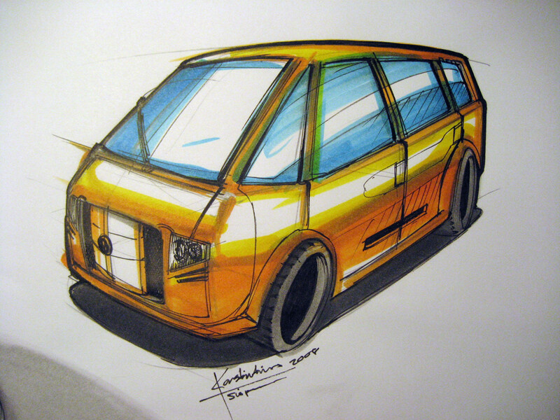

i also did this van and truck recently
Nice overlay bennybtl. I love to see that people are comfortable enough to throw down some overlays for each other. Keep up the good work.

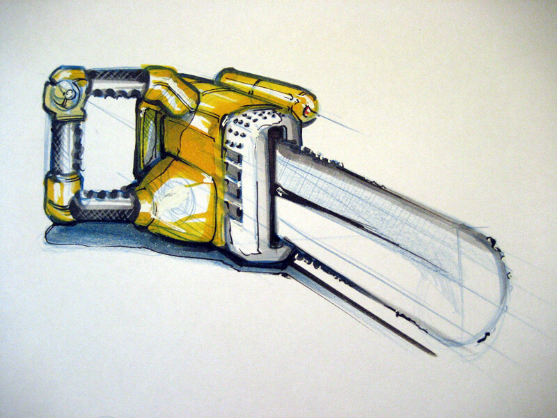

Nice improvement. A few things to try:
Simplify: can you communicate the design with less. Can forms merge and communicate with one another so the product has more flow, or a holistic feel.
Perspective: This angle is not particularly informative. The blade right now draws the most attention… in essence the part with the least design has the most prominence… flip that. I want to see the other side. How does it look as if I was approaching it to pick it up?
More sketches!

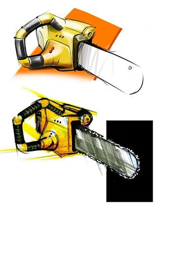

I decided to work with photoshop a bit:
Get the sketches right first, photoshop later.

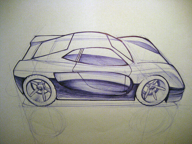

  1. car

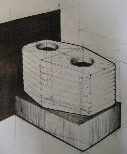

  3. pencil sharpener

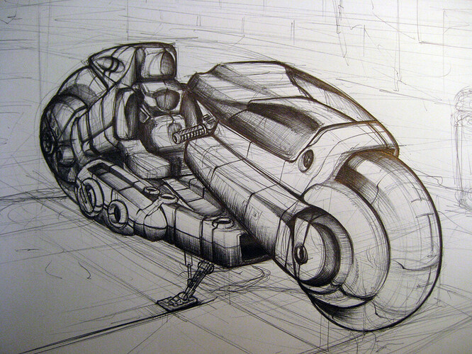

(bonus: bike from Akira – drew it and it almost spanned my 11 by 17 paper, looks better in person)
