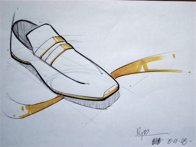

It is pretty good, and I would even say much better than mine! My only suggestion is to tone back on the drop shadows. They look too much like part of the product.
Had shoes on the brain this weekend. It is amazing to me how small changes can make a big difference in the way a shoe looks. They are all about proportion, something I have not yet entirely figured out.
