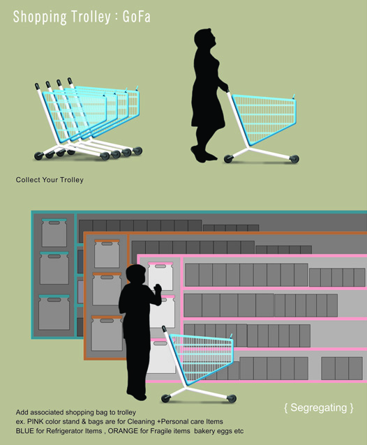

Here is my proposal for…CHECKOUTS
Shopping Trolley: GoFa
Checkout is a main bottleneck at Supermarket :
Scanning of merchandises,

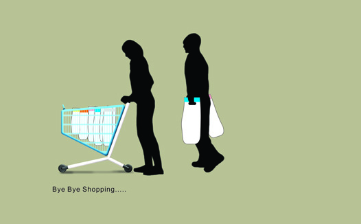

Billing & Payment,
Segregating & Packing these merchandises in the shopping bags.
With GoFa, this work will get distributed between User & Staff.

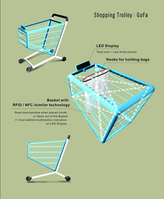

The Basket mounted on GoFa is capable of reading any merchandise when it is placed inside or taken out of GoFa.
It is equipped with RFID, NFC or similar technology. The edges of the basket will interact with each other & tagged merchandise.
Then they pass its info to LED display. (Feedback to User)
The merchandises are divided into groups which can be packed together. The display shelf of these groups & their shopping bags will have a same colour indication. (for example, PINK color stand & bags are for Household Cleaning +Personal care Items
BLUE for Refrigerator Items , ORANGE for Fragile items: bakery, eggs etc )
User can collect the shopping bag from the display shelf, add merchandise to GoFa , can view the cost details at LED display of GoFa.
At checkout, Staff will connect GoFa to the system. Take payment & tagged merchandises will get released.

In your scenario, the need for an intelligent shopping cart isn’t needed.
You are assuming that each item in the store carries an RFID tag, so that it is scanned when it goes into the cart - but now you’ve created a cart that has lots of technology baked into it, and if you’ve ever been to a store that chains their carts up, you’d understand why they are frequently stolen, hit by cars in the parking lot, and more importantly - never in one place long enough to charge all of the equipment you’ve added to it.
If each item already had a RFID tag, theres no reason for smarts to be in the cart/trolley, you’d just need fixed antennas at the checkout lane that could read each item - though this is also a challenge in itself. What if the RFID antenna misses an item, or accidentally grabs an item that someone else didn’t want to take but left it somewhere near the end of the store.
In the ideal world, you wouldn’t need a checkout at all, you could just walk through the “magic portal”, have everything get scanned, and then tender your money and leave.
The technology is already there, but it’s going to still be a while before tagging every item with an RFID tag is feasible, and more importantly - creating a system that audits what is in the cart so that people don’t throw items into the basket and then walk out of the store without paying.
Remember that grocery stores run a business where profits are very low, so adding the cost of a few cents to every product for an RFID tag still isn’t feasible, and technology advancements (like self checkouts, personal shopping scanners, or smart carts) need to be able to prove their ROI for them to even be considered.

There are few things that I wanted to address while proposing the concept.
Mainly reducing time spend at Checkout. Otherwise everything else in this system looks smooth.
So distribution of work (checkout work) should happen comfortably while you are shopping.
I am assuming here a simple technology which able to detect the item when placed in the trolley cage.
I have just referred it to RFID or NFC or similar technology.
It could be something that you can attach to the trolley & can be removable before exit.
Online shopping is growing up & there are multiple advantages associated with it.
It will not completely replace the existing system.
That part was understood, but my point was that your assumption is that the technology is passive, which requires an RFID tag on every item in the store.
Since that’s part of the assumption, theres no need to scan as you pack (which is what current self-shopping assistants like this Motorola's handheld MC17 computer awarded thrice - Core77 do) those RFID tags could all be read instantly as you are leaving the store.
RFID is a fairly “dumb” technology, in that an antenna will read anything it is designed to point at, but it can read hundreds of tags instantly, which would still lend itself to having the equipment only in a few spots (checkout area) rather then per cart.
