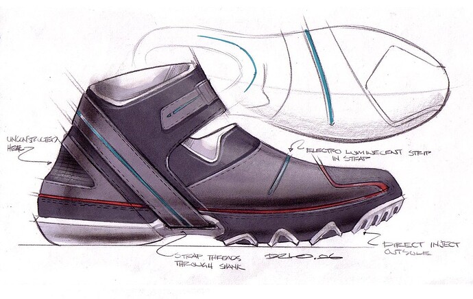

I usual sketch up a proportion I am looking for an use it as an underlay for all my concepts so they are the same size and proportion for that round of concepts.
thanks for the quarter back, it makes perfect sense…what kind of paper are you using to be able to see the underlay? is it just copy paper? and then i’m assuming some sort of marker paper for the hand renderings?
I use graphics 360 (marker paper) for sketching because I like the way prisma pencil glides on it, then I photocopy the sketch onto regular copy paper to render with markers because I like the way cheap bond absorbs the markers and makes it look matte (you don’t want your shoe to look all glossy, it should look soft like it is sewn together…) and use some white and black pastel (which grabs nicely on the bond…)
This is just for initial concept drawings, sometimes I scan the sketch and render it quickly in photoshop instead of using markers…

MD: How do you get you linework to look so neat…french curves? i seem to be able to only draw jagged lines. :neutral_face: And the bigger the drawing, the worst it gets. hmmm. any tips?
NO CURVES, I don’t like to use tools, just a straight edge for a ground plane…
I use prisma pencils on graphics 360 paper, I think this helps me make smooth lines. I also learned that old Jim Or way of sketching: Keep it light until it is right: sketch very lightly and then come back in with darker and darker lines as you go using both the tip and side of the pencil. I also overlay my ideas a lot, I’ll do 5-10 quick overlays within 5 minutes of an idea before I start investing time in it… I think this gives me a good feel for how I want the design to be, thinking it out on paper instead of in my head. Then when I throw down the final sketch, it feels more natural.

Anyway, to the OP, yes I cheat. If it’s an existing last I photograph it (top and side views) so I can get the proportions correct. The better your proportions are the easier a job the pattern cutter has, so you soon learn!
If I don’t have the last I find a shoe made on that last. If I have neither I adapt something. Then I do what Yo does - I have one template and trace over. Sometimes when I need loads of upper ideas and have no time, I sketch the outsole then scan it and print off loads of copies to save sketching the outsole again, so I can concentrate on the uppers.
