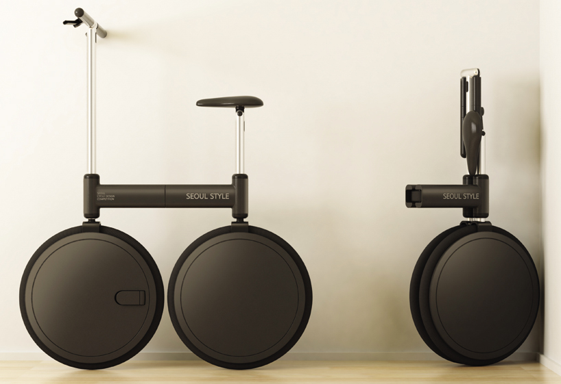

How do you pedal this bollocks while you steer? don’t you like your feet?- and direct steering straight down?

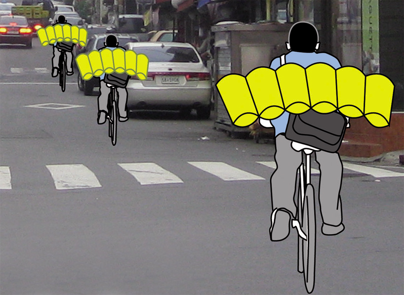

Visibility and ‘filters to clean the air’. Are you trying to get them airborne? Why should a cyclist clean the air?- they’re not polluting it.

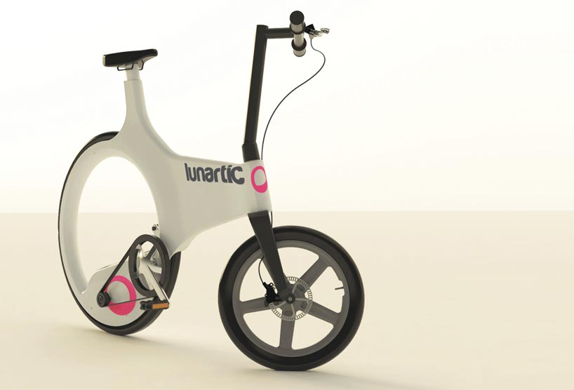

and for the hubless aficionados:
(fair play to him that he has built a working prototype, and it has a powertrain and brakes)

Ugh. Where to begin? As much as I despise the hubless wheel concept, I will cut some slack because it actually is a working prototype (regardless of how well it works…)

I was also intrigued by this entry, while it’s still a stretch at least it was something fresh, with an interesting take on the manufacturing process (whole frame is one injection molded plastic piece), and a cool, albeit maybe overly optimistic, use of the living hinge mechanisms possible with plastics.

Props to the guy who build the hub-less wheel. Though, he did take up about 1/3 the space of the hubless part with those pesky gears and belts and chains and whatnot that leave grease stains on your pants. :unamused:

Looks to be Gates Carbon Belt drive. No maintenance! Silent! Genius!
