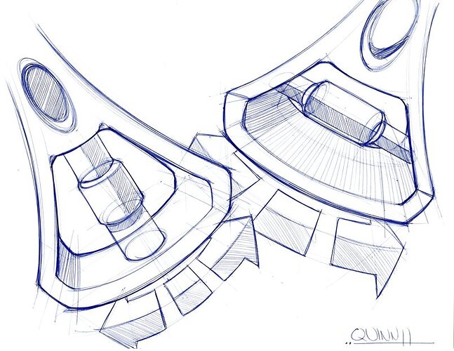

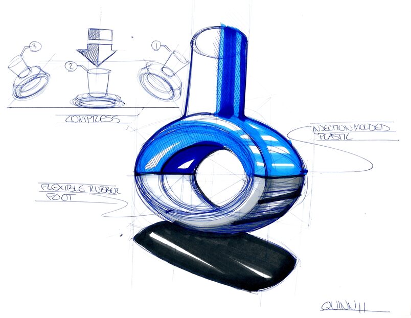

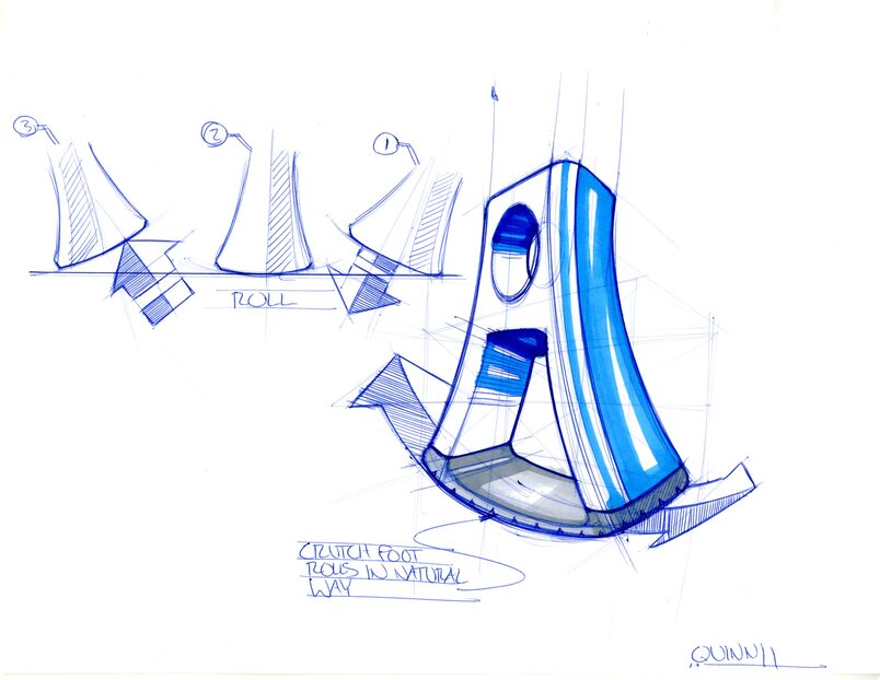

Crutch Foot
I have been looking at natural foot strides and wanted to mimic it with the foot of the crutch…
Or created a foot that helps dampen the blow when it makes contact…
Armpit Pad
I have been ideating on some type of skeletal system for the pad that allows it to conform to many different shapes and sizes, as well as, provide some movement and flex…

You need some context / people in those sketches… I have no idea what those are or how users interact with them.

Tarn is right. Add more people into your ideation sketches. This is a very strong human factors project, so you need to present that upfront - A lot!

Interesting ideas with the sketches, but I would focus much more on the research, observation, and market analysis first, then go to mockups and user testing.

The reason I started sketching was to help get my initial ideas on paper so I can move on. Now I am in the research process, which I will get more into on my next post!

@ tarng…
Agreed–I just wanted to get some quick initial ideas I had about some specific details on paper.

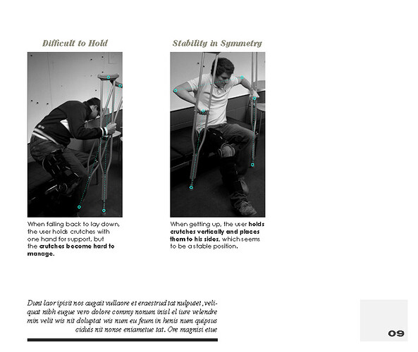

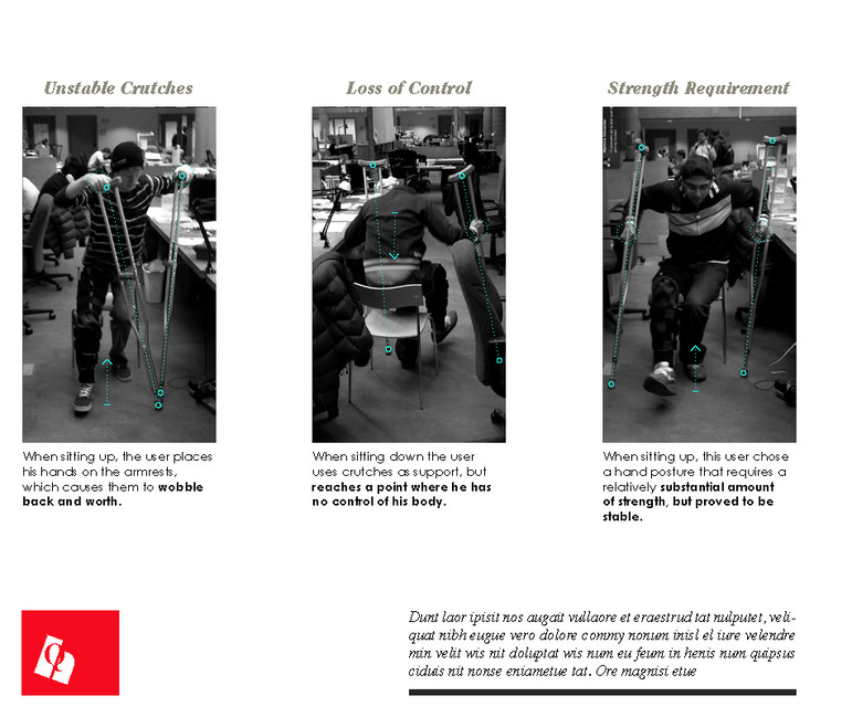

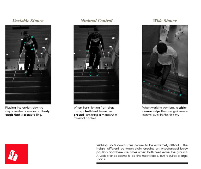

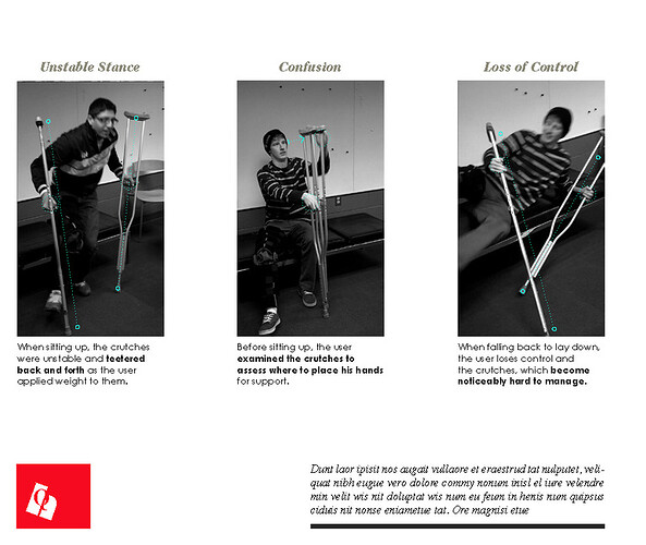

Here’s an update on how my research has been going…
Lately I have been asking fellow classmates to wear a full leg cast and use walking crutches to perform certain types of tasks that a 6-9 year old would experience on a daily basis. These tasks include:
  1. Locating their crutches & sitting up from a chair
  2. Picking a backpack up off the ground
  3. Walking with the backpack on
  4. Placing the backpack from their body to the ground
  5. Walking up a set of stairs
  6. Opening a door
  7. Using a water fountain
  8. Walking down a set of stairs
  9. Laying down & getting up from a couch (simulate getting in & out of bed)
  10. Sitting down in a chair
They perform these tasks in order as listed above while I record their process with a flip video camera. Once they have completed all the tasks, they are given a survey where they mark on a human body illustration where they experience the most discomfort during each task.
So far I have gained some valuable insights and have taken screen shots from the videos so that I can make annotations of certain observations.
I plan on comparing these results with the information that I gain from the my pediatric physical therapist interviews. Also, I am working on getting a few opportunities to observe and possibly interview my user group–it’s been difficult though.
Laying Down & Sitting up from Couch
Sorry for the weird text in the images by the way. It’s filler text for right now (these images are from my in process thesis book).
I found it interesting different people held the crutches in different areas to assist themselves to get down/up. There were even moments of pause where the user would examine the crutch to see how he should hold it. Also, the crutches were very unstable as people applied weight on them to get up.
The crutches need a way to be connected together for storage when not in use or when used with one hand. Some of the pictures show how they can easily become hard to manage with one hand or when laying down.

Walking Up & Down Stairs
Sitting Up & Down from Chair
Good to see you are researching. Quick (hopefully obvious) point however-
Testing on full sized adults is less than ideal. Adults have different body proportions and more importantly much more developed upper body strength. You need to use real kids, or change your target market. Doing the majority of research on adults will really skew your results and I think be an obvious negative in a portfolio piece.
@ R
I agree and this has been one of my main concerns. I am actively pursuing potential opportunities to observe my user group, but with no luck so far.
I was planning on taking the results from observing 20-23 year olds and applying those to my user group, while obviously taking into account the physical and proportional differences between the two. For example–if it requires noticeable upper body strength for a 20-23 year old to support himself/herself when sitting up then it will be a much larger burden on a 6-9 year old–making it an issue that must be addressed.
With prototypes–I was planning on scaling them to a full-sized adult for initial testing. Then after a few iterations scale it down for 6-9 year olds and have my professor’s son (who’s 6) test them out and give me some feedback.
What do others think of this approach? Obviously it would be ideal to only observe and test prototypes on my user group.
Honestly, doesn’t sound good to me. Can you just change the target to better fit the population you have access to? Given that this kind of project is very heavy on research, ergonomics and testing, I think it would really be a complete waste to do everything for adults, then just scale up in the end after making so many assumptions. It would be a huge red flag for me a a portfolio, like doing a project for the blind and just testing everything with a blindfold on normally sighted people (Unfortunately, I’ve actually seen that in a portfolio).
Just being honest. Hope you can find a solution. You don’t have any cousins or neighbor kids you can borrow?
