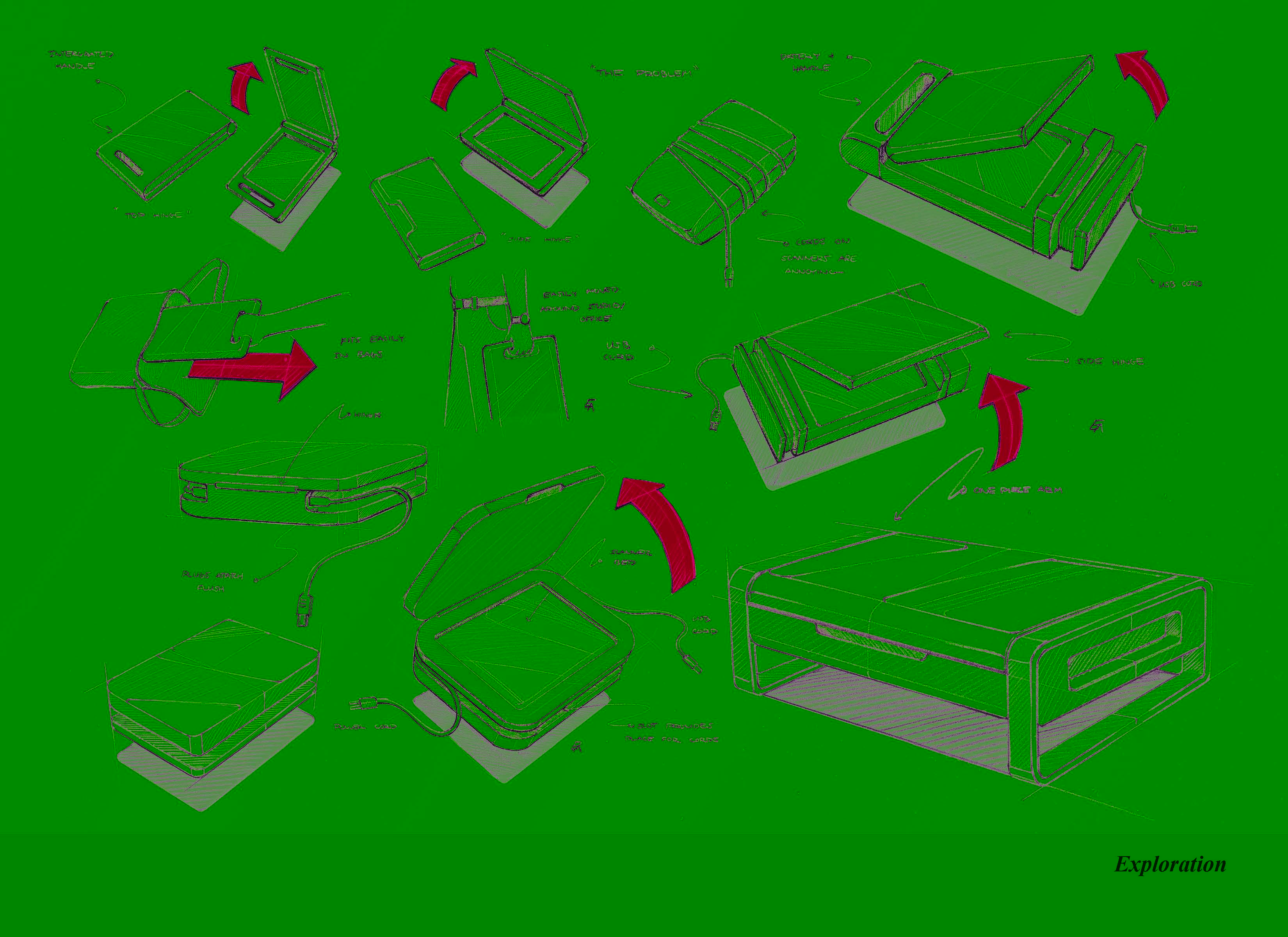

Hey Guys,
So I have been working on this concept in my spare time off and on and was wondering if I could get some feedback…
As designers we spend a lot of time around scanners. I have used a flatbed scanner daily over the last few years and have always had some issues with them. A few weeks ago i started sketching out concepts for fun so I just kinda kept going and pushing it further.
Some of the issues I wanted to address were…
  • Cord Storage, I have always been annoyed with cords on scanners especially since scanner sharing is pretty common in the office.
  • Office portability, this ties into the cords, but plugging and unplugging has always been a burden, and the wires always end up separate or lost form the scanner.
  • Aesthetics, I have always been interested in breaking form the generic black and silver plastics of the home/ office electronics market and thought it would be quite unique and appropriate considering a scanner is often a creative tool, and was heavily influenced by Marcel Breuer’s chairs. (threw a quick image board together of some inspiration.)
  • There are some other features as well like a flush scanning bed so paper is not crimped, horizontal opening, and a place to place scanned documents which I have also considered but are not key drivers.
    So having done a good amount of sketching, I thought I could get some feedback from you guys. I am just doing this project for fun on the side and after some chipboard mockups, would eventually like to build this concept in Solid works to hone in my SW skills.
Thanks!
The one thing that i would like to see is a way to solve the issue with scanning anything with a bind. Obviously scanning a sheet of paper is never a problem, but I hate trying to scan in a sketchbook or magazine. I would like to see some sort of detail that compensates for the bind so that you dont get that weird distortion/discoloration that always happens. Also, the lids never close properly on thicker materials so you either a) get blinded by the light (insert Manfred Mann here) or b) have to photoshop out a lot of crap and sometimes doesnt expose the page correctly.
This older UMAX scanner had a cool hinge feature that allowed the lid to raise up vertically and hinge open to compensate for book bindings, sketchbooks, or larger items. If I remember right, you could completely remove the lid, too. It’s probably 10 years old at this point.
NURB: Don’t most scanners have that? All the scanners I’ve ever used have that feature where the lid can lift off to be parallel with the scanning surface.
The cord thing is a cool idea, but I think it’s too big and could get in the way of scanning some stuff since the scanning surface is inset and if you had a large book you wouldn’t be able to hang it off the side. I think you could look at some pull-out surfaces for when a large thing is being scanned. I also think there needs to be a more elegant solution for the cord/handles. It looks unresolved/unfinished. It’d be more elegant if the cord were more hidden when wrapped, and if the handes looked more… handle-y. These things are heavy, and those handles look like it would hurt to carry.
Really nice sketches though…

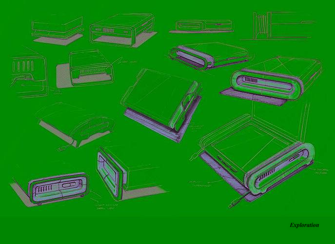

For some reason, the when i click the images the colors are inverted? Anyone else have this problem?
+1 on the hinge that allows the lid to elevate. I have it on my old HP scanjet. Its very convenient.

Flush scanbed is sweet, seems like you solved that one. (hate not being able to scan A3’s flat)
My second biggest pet peeve is the space it alocates. Wide + flat, and the lid hinders me to put stuff on top it for longer periods of time. Id rather have seen something done about that then the focus on mobility. Guess its more relevant in my case, but then again, its not my project :slight_smile:

I suppose they do. I just remember that particular scanner having about 2" of room to raise up while still having the lid on.
bngi - I have that problem too. Really annoying.
I guess our scanner here has the lid that raises, but it still struggles with anything bound. No matter how hard we try (usually pushing down on the bind hard), there is still some weirdness happening at the middle point. This happens a lot on larger books. I almost want the scan bed to go all the way to an edge so that I dont have to put in the entire book spread open. I would just hang one side off the edge, allowing the page to sit perfectly flat against the glass.

I definitely agree with the the hinge issue, sketchbooks and other bound items have always been difficult when it come to scanners, it seems that a variable hinge, something like a four bar linkage with just one linkage so it can fully open on the front would be a good solution. All the scanners I have interfaced with have never had this feature and it would definitely be useful.
A flush scanning bed would also be a great feature, I think the length can be limited by A3 size but having it flush off the edges would help scanning larger documents (8.5 by 11’s) ect. You wouldn’t be able to scan the whole document, but you could definitely scan half and not crimp the paper. The recession in the scanning bed is meant to interface with the gasket on the lid, but I think this can be solved by simply improving the gasket.
tarngerine: You bring up some good points about the handles and cord storage. I am quite split on this issue because I can see it both ways. I think incorporating the cords as part of the aesthetic could be a really nice feature, similar to the way some lamps use the exposed cording. Maybe colored USB and power cords (orange, white, ect.) I see your point about the handles though, they are definitely not your “grab me handles” but rather a subtle detail which could allow for holding. I am very inspired by incorporating elements of furniture into home electronics and think these chair leg like features could be a really nice touch. I think my next step is to do some small mock-ups to help make some decisions.

Very nice! I like the simple idea of letting the paper pass through the hinge, always a sore spot when I’m trying to tile scan a large sketch. Love the cord management, I like how your thinking is visible in the sketches. Also, nice inspiration board, would be also nice to see a user persona and scenario, with some images of hypethetical environment for the product.

Regarding USB cords, I just bought a Canon printer / scanner that is WiFi enabled (MG5280), touch the green scan button on the scanner and it scans and sends directly to your computer or another. No single simple function on a recent electronic device has made me happier, I hate cords. In a forward thinking project such as yours, I would assume no USB cabling needed and use wireless transmission.

Nxakt, Thanks! about the sketches, big fan of the old school style. In terms of the USB cord you bring up a great point. I def see the benefits of wireless transfer and i have considered designs where the USB is eliminated but the power cord is still kept and integrated. However there is a certain simplicity to the analog cord which I believe is satisfying, a very clear link from the scanner to the computer. However I am def going to explore some more concepts with just the power cord in this next round.

I don’t see them inverted but the background color is very blue/green. If I save the picture it looks like a more typical gray (which I’m assuming is correct). Very weird.

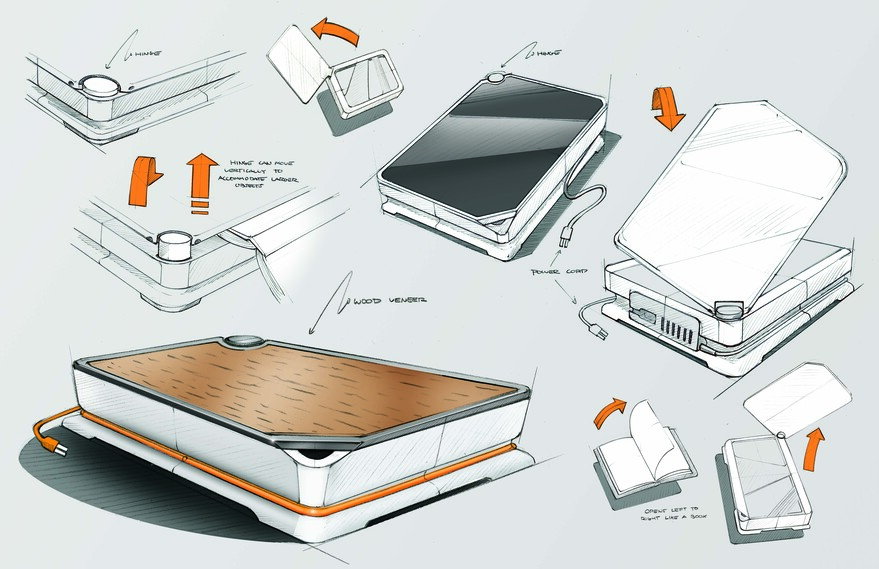

I have done a bit more work on it since last week, getting pretty into this project.
Atohms, cool concept looks pretty wild, def out of the box thinking (no pun intended)
Oh and on the wireless note I have started playing around with this concept while keeping an elegant solution for the power cord.
So after a lot of good feedback I final got a chance to start exploring more concepts.
These are the main drivers for the project now.
  • Scanning Bed ( Flush as to not crimp paper, ability to fit items hanging off the bed, ability to fit larger items, books sketchbooks ect.
  • Cord organization, ability to store power cord, possibly USB cord (wireless?) neatly with an integrated aesthetic.
  • Form and aesthetics inspired by furniture, as well as placement for items on top when not in use.
Still open to other drivers but this is the direction I am heading in.
Your first two posts contain JPG images that have been saved in CMYK mode. When viewed, they appear to have the colors inversed.
