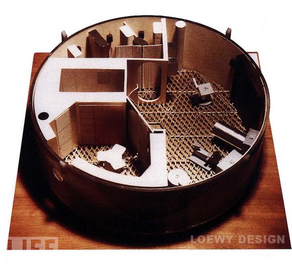

I uploaded some vintage Loewy work from Skylab here which might be nice reference for you in terms of showing some of these ideas in a more visually compelling and self explanatory way:
Hi Michael,
Thanks for that. I’ve already looked up as many of the Loewy drawings as I could find when this project began. I really admire the sketching style and the clarity of the concepts shown. Unfortunately, I’ve found it hard to do my own drawings in a stylized and clear way as I usually would for products, because the project is so complex and so far removed from anything I’ve ever worked on before. Most of the sketches you will see are mostly for communicating ideas to teammates, so they won’t be flashy. Perhaps I will refine the sketches a level further to try and achieve more visually compelling and explanatory drawings now that the ideas are more solid.
It’s not about being flashy, it is about being clear, communicative, and compelling. Nothing less than the best you can possibly do. Make the viewer want to understand it and want to see it built.
Very true. I most definitely agree that being clear and communicative is the most important thing when sketching. I will have to work on the sketches I continue to do to make them communicate these complex ideas better.

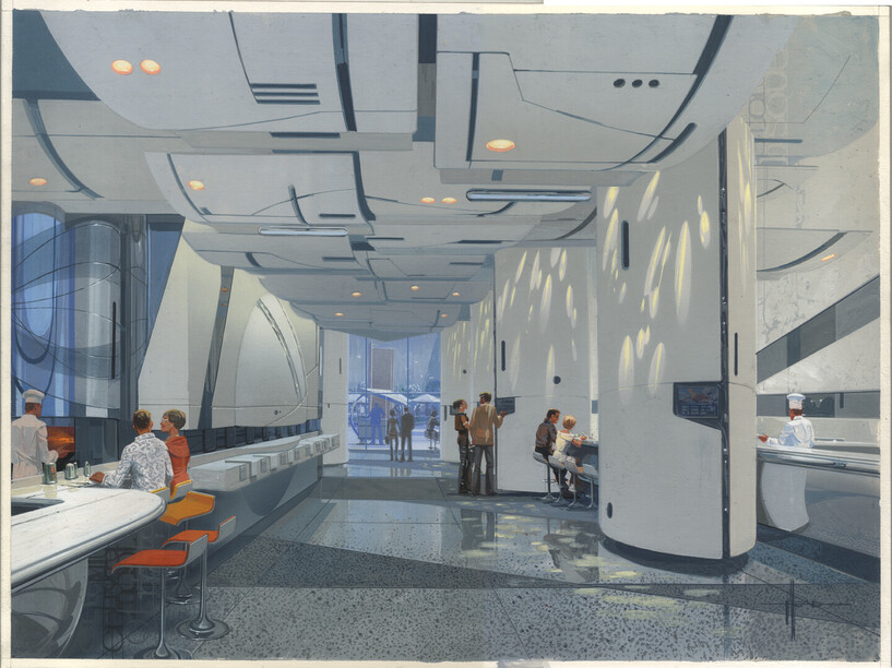

a little Syd Mead for inspiration:
