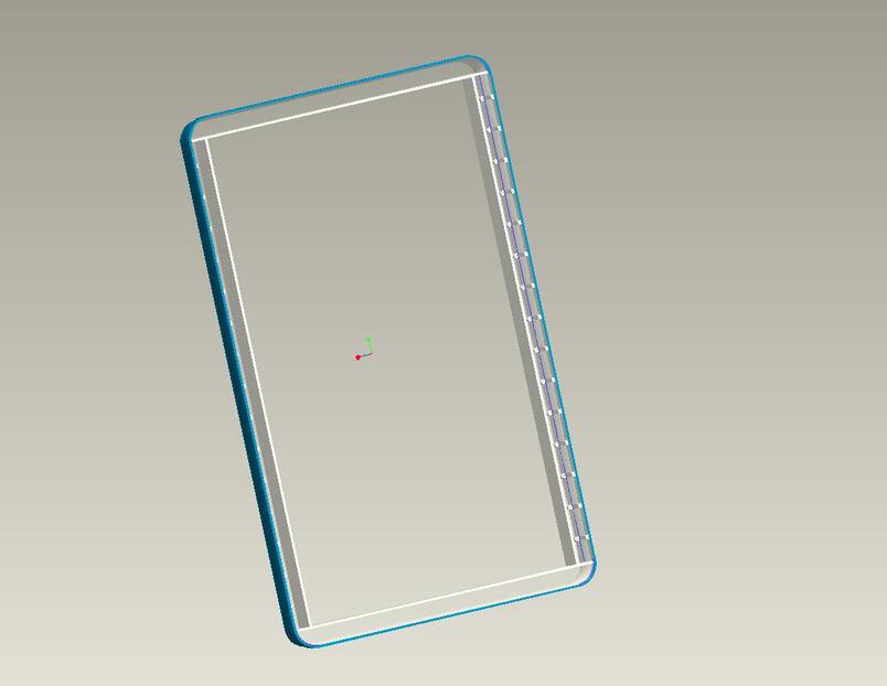

I have a large door frame I am needing to get manufactured. It is effectively a bezel for a kiosk-type display.
I have attached a .jpg showing the basic concept. It will have a piano hinge running down one side. I anticipate inserting PEMs for the hinge to attach.
Where I am stalling on this is the manufacturing of it. Even though the voloumes are low (30ish?) I tend to think they are high enough to warrent not hogging them out of a chunk of plastic via CNC.
I am thinking RIM molding. So my question is two-fold:
  1. Do you have any other suggestion for manufacturing this thing (it is approximately 3.5 ft X 6.5 ft.)
  2. Do you know of any RIM molders that are either A) Canadian or B) in the Pacific Northwest or C)Asia based but can offset the shipping costs with their lower pricing.
I can send a quick .stp file if you need to see it more closely…just pm me.
Thanks!!!
I guess my first question would be, why RIM molding? The tooling required is just as expensive as any other sort of injection molding, possibly more so, and I can’t imagine it would be cost effective for such a short run.
For something of that size, my first instinct would be to go for a vacuum or pressure-formed part – you can work some very thick sheet materials these days, that may address whatever structural concerns you’ve got, and the tooling is way cheaper.
I considered thermoforming…but stalled on it considering the structural and mounting strength I need from it.
I have never done a RIM program. I was under the (wrong?) impression that the tooling isn’t nearly as expensive as other conventional tooling. I always thought that because of the low pressure, softer materials than steel or aluminum could be used.
I will rethink the thermoforming.
thanks.
I haven’t designed for RIM before, but as I understand it, the pressures are similar to standard injection molding, and hence the tooling has to be of similar material and complexity.
Regardless of material, an injection tool base of the size you’re describing is going to be awfully expensive – which is why the only parts of that size I’ve ever done have been thermoformed (or rotomolded, depending on surface finish requirements).

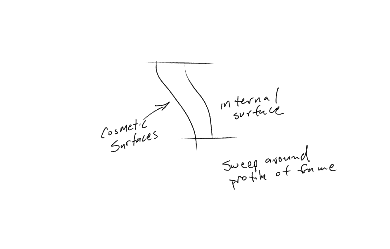

5K - 6K for tooling is not such an issue for this part (the final cost for the product is ~$30K). Getting it CNC’d would be in the thousands per which is cost prohibitive. Amortizing tooling costs, as long as they aren’t astronomical, is less an issue than high part costs. Bent tubing doesn’t work either, as the outside A surface cross-section is effectively an ogee curve. Well, unless there’s some kind of process I am not familiar with.

Your first image did not communicate the cross section to me. Now I understand. Should look nice!
just a thought, get a alumiumum extruision die made (7k) and have tube extrueded…done.
Could that then be bent and welded to be seamless?
I imagine you could fabricate the hinge mounts into it?
