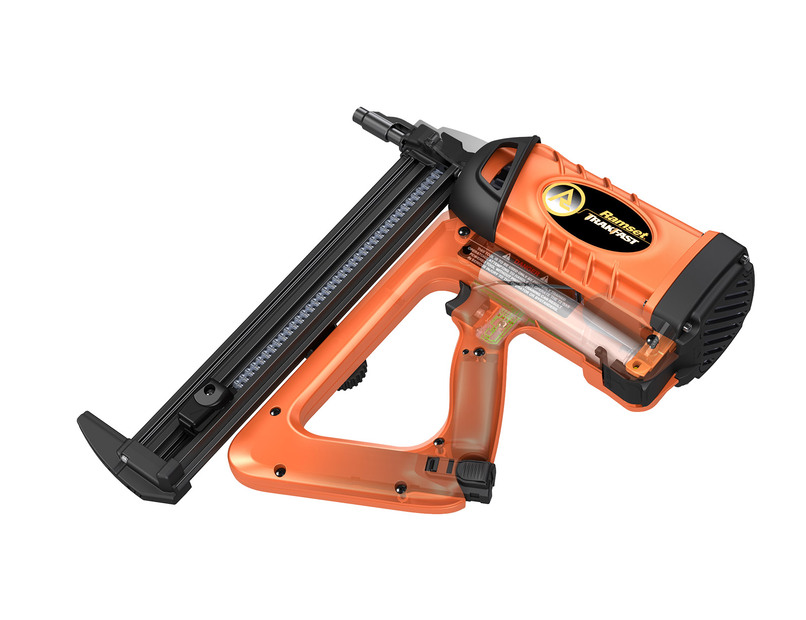

I for one would like to see more renders from everyone. Esp if it’s native in Solidworks and not using a plugin. What we need in our workflow is a tool that does good enough otherwise a plug in is necessary.
These renders are all several years old but are all native SolidWorks Photoview 360 with Photoshop retouching/ enhancement.If you’re willing to take the time to set up the render and materials, SW can produce excellent results without having to use another package.
