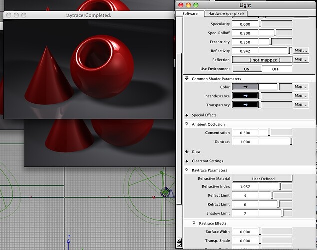

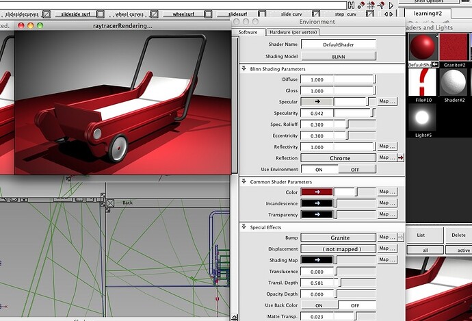

I’m really struggling on making my shaders glossy/reflective. I want to have my materials reflect what’s around them (other materials, shadows, environment), but I have no idea how to do this. I’ve looked through some books and I really need some help.
I’ve attached a screenshot showing what it currently looks like + some of the settings. Any tips would be greatly appreciated.
start by using one of the default rendering environments. The black and white stripy one is a good starting point to get shiny stuff looking shiny. It can be found in the Environments tab in the visualization mode of the side control panel.
Turn off “use Environment” . That seems to be mainly a setting used for hardware shade. for Software rendering, that is telling the raytracer to only use the environment to reflect. with that off, it will reflect everything including the env.

Tangerine: You have to describe what you are after a little bit more. I notice your shader has a bump map. That bump is going to blur out any reflections. Also, are you using spherical images for your reflection map? That makes a huge diff.
Do you want it to look like this?

One thing I’m having troubles with now is reflecting other stuff. So in the attached image, I have a cone and a sphere (reflective) on a plane (that’s curved up in the very back, much like a photo studio setup). The settings I have open are for the shader of the plane the objects are on. I’d like to reflect both the cone and the sphere on the ground plane, but not reflect the HDRI. so I have it Use Environment:off. However, it still reflects the HDRI (you can see in the top right a white stripe running diagonally, that’s the plane catching the HDRI reflection. Also, only the cone is being reflected, not the sphere.
any help?
also i dont think the shadows look realistic, is that just me?
how do i pre-compute ambient occlusion?
Calculate ambient occlusion by going to render->Ambient occlusion. But first make sure your normals are all in the right direction by going to Surface Edit->Set Orientation (You want everything blue, not yellow - you’ll wind up with a dark patch if your normals are wrong).
RE the issue you’re having above - could you post your wire file?
Are your sphere and cone the exact same shader? It’s hard to tell but it almost looks like your sphere isn’t reflecting in the cone either.
It’s kind of funky but I can’t off my head figure out what the story is just by seeing that one setting.
I know that these are going to be no-brainer kind of suggestions, but it’s always good to start off with them:
check your reflection settings. Are you allowing the rays to reflect enough?
check your visibility settings (this might only be in Maya…can’t remember). Is the sphere set up to be visible in reflections?
