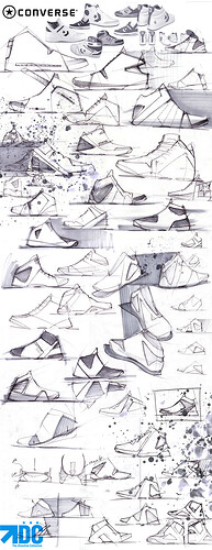

below is some thumbnails i did a while ago similar in size. note how you can use less lines and even perhaps some phat marker to indicate shading. a good exercise you may want to try is keeping a timer or clock handy while you sketch so you spend a minimum of time going over lines and keep things loose. try 15s per sketch, then 30s, etc.
post some more and im sure you will quickly improve! you can also try sketching an existing shoe from a photo with different views or variations so again you arent thinking about the design and just concentrating on the lines and fluidity of the sketch.

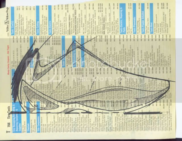

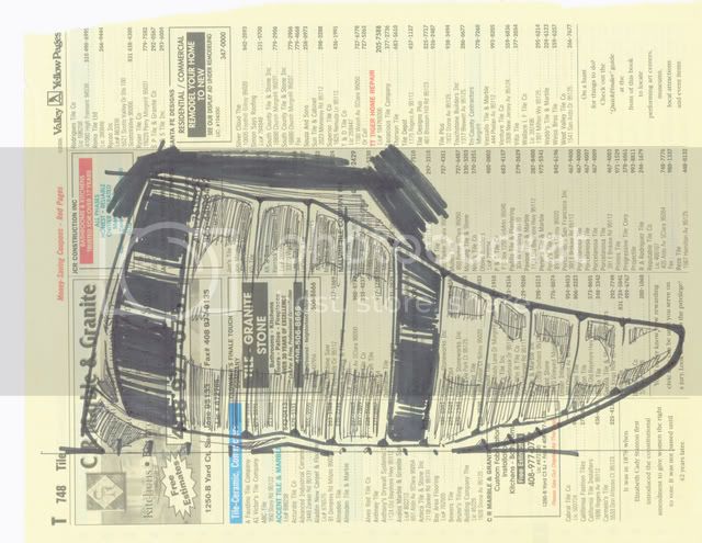

so after all the supremely awesome advice, i went home enthusiastic and raring to try out all the tips you guys graciously dished. problem was, i didn’t have a single shred of newspaper to draw on. i tore my whole house upside down trying to find some, but to no avail. then i remembered what was sitting outside on my porch! something just as thin and flimsy and way more abundant. and so here are some sketches i did with a fatty sharpie and a thin black pen. i’ve gone through about a sixth of this phonebook and think i’m going to make it my new sketchbook or sorts. it’s always humbling to see everyone’s work on this site, but at the same time, it’s what propels me to get better and better. thanks again for all the advice and for any comments that will point me in the right direction.
“and he dids’t maketh the product shine, likening it to a million heavenly bodies radiating and bathing it in white-hot star light”
-taken from the book of Kardacia, written by the
head priest of the house of the lens-flare.
Lose the phone book asap! You lines are definitely looking better, huge difference. Good work.
wow, what an improvement! good work! i actually kinda like the phonebook background, and can imagine what its like to sketch on something that you dont really care about given you have 500 more free pages to use… personally i always find my best sketches are on lose scrap bits of paper, when it doesnt “matter” and get a lot tighter and with worse results the better the paper is (cant deal with sketchbooks!).
keep it up!
MUCH BETTER. That had to be all caps. Those sketches are hot. Great linework and form explorations… I wish it was on blank paper though… get some of this my friend:
http://www.google.com/products?hl=en&client=safari&rls=en&resnum=0&q=newsprint+pad&um=1&ie=UTF-8
Really loving the linework, super expressive and communicative.
friggin’ sweet! the ones in this last batch that look the best are the ones where you started varying the line width(s), you could try a lil’ more more of that. also it might be good for you to switch back & forth between sketching small , medium, & large sized joints, with the goal of achieving a somewhat consistent quality no matter the size.
