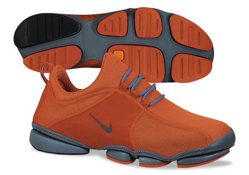

haven’t seen that but doesn’t really look too new in theory. The nike presto clip (below) had a similar construction where although the midsole wasn’t meant to be removable it could be popped out from the TPU outsole base pretty much as shown in the concept.

I also was thinking about the Clip.
