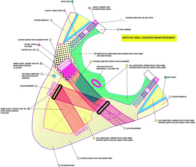

Rest of that comment tech pack for those interested.
