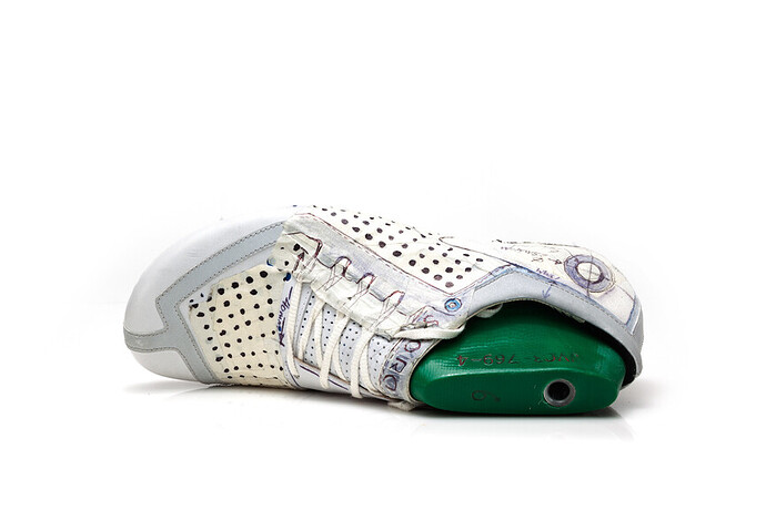

Some good ones on lasts…

3 Secrets of outsole design?
  1. Make it functional. Every part from toe bumper to lug to sidewall has a purpose.
  2. Make it graphic. Consider how the outsole looks from every angle, mirrored left to right and as a negative in a footprint.
  3. Make it work. Understand the specific use case (road, trail, etc.) and the performance needs.
