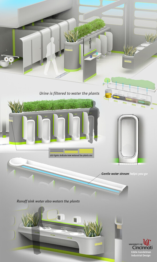

I designed a public restroom for our junior year “workstation” project. The restroom takes place in a corporate setting, where there will be over 50-100 people using it, and there is a unique kind of psychology happening. The main focus in my design was the urinal station, and the idea was to distract people from the anxiety of the public restrooms by making the act of urination an achievement – it waters the plants in front of you – and a way to bring corporate values like working together into the restroom – LED lights display how watered the plants are, so as more people pee throughout the day/week, the LED bars will raise. This also gives you something pleasant to look at and an easy way to talk to the person next to you (“Watering the plants again, Bill?”) The filtration system uses activated charcoal, crushed limestone and greensand to filter urine of harmful toxins, acidity, salt, among others to make it useable to water plants. This was suggested by a professor of horticulture specializing in toxicology here at the University of Cincinnati. On a more physical level to help people “go,” there’s a gentle water stream built into the urinal station for auditory and visual aid.
The sink area also features a filtration system to use runoff water to water the plants on either side. I used a lot of filleted corners as a design aesthetic to make sanitation easier, and give the room a softer, welcoming, less harsh appearance, which I felt may help people do their “business” and have a more pleasant public restroom experience. Thanks!
I like the concept and the story boards. Clearly explained and a good balance of aesthetic and psychological improvements. I think it might be even greener to use waterless urinals
The “watered level meter” makes me giggle.
Definitely not a typical project. I think your general direction of water filtering/ sharing is good. Renderings and overall aesthetic are nice and clean.
Some things I would have liked to have seen considered.
-Is the space scalable? Here in NYC we have a lot of standalone 1 toilet restrooms. Could this be scaled down to that? Could it be a more modular construction type to allow for easy retrofitting of existing bathrooms?
-As far as the actual urinal goes, is there some new kind of urinal archetype maybe? There’s a lot out there, but your form doesn’t necessarily tell the story that your pee is watering the plants.
-Addressing the issue of “back splash” might be a good basic usability problem to attack.
-Rethinking The Stall would be a great project in itself, but maybe too much for the scope of this one. It would have been nice to see a little thought there though.
-What about sunlight for the plants? Could your pee stream spin a water wheel to generate power for growing lights?
seems like you had fun. What’s with the coffee mugs chillin on that ledge?
Gross and Awesome! Cool concept. The only major flaw I see is that unless you have a pretty slick hinge, those doors to the stalls aren’t going to open.
Ha! I’m glad you found that. I realized that it wouldn’t work the night before it was due; the best solution I thought of would be offsetting the heights of the doors so that they pass over the dividers. Thanks for your time! I’m planning on continuing this project for my senior thesis, so all your comments are extremely appreciated!
The ledge is because this was designed to be in a corporate setting, which I forgot to mention earlier, so employees can have a place to put their mugs and clipboards when they walk in. The whole “peeing to water the plants” is also designed around corporate values like teamwork, raising the bar, and stuff like that so that urinating to grow plants is a way to “play your part” within the system kind of thing, and maybe give the employee a boost of confidence!
I’d still like to see you explore the circular layout we talked about when I was at UC.

Hey Mike, yea, that would’ve be interesting if I had some more time. The main feedback I got was to take the concept further, be more controversial, and I think something more radical like the circular layout would’ve been sweet. Maybe next time :slight_smile:

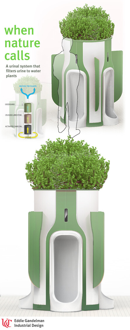

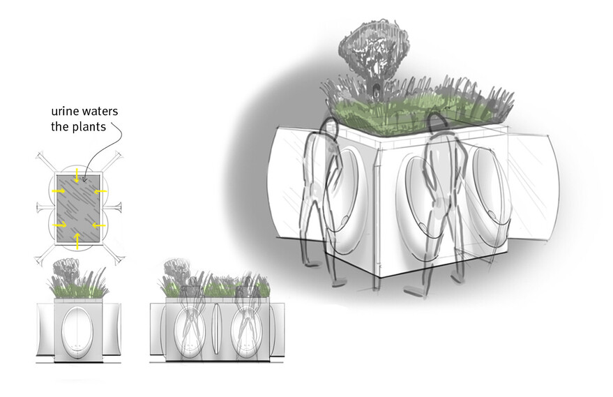

I know it’s a little delayed, but I finally was able to finish up modeling and rendering this urinal concept. You can see the original sketches of it that I did a few weeks into the project (which were abandoned for a slightly different concept), which were resurrected with this render. The sink/washing station and toilet station are still in the works, I just wanted to post this to get some feedback.
Again, the idea is that the system filters urine to water the plants in front of you. So you not only have something nice to look at while you’re going, but it also makes you feel like you’re contributing to something while you urinate.
Let me know what you think!
