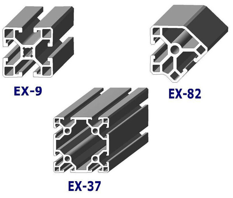

Hi everyone. I am working on a project of a structure for solar panels which requires custom aluminum extrusions, and I was wondering how I could prototype them. I was thinking of machining them, but the profiles may be a bit too complicated and the extrusion too long, and expense of this is an issue as well. The prototype has to be constructed with the final materials, but not necesarilly withstand the stresses and strains the final product would have.
Do you guys have any suggestions? How is it normally done? Thank you.
Is there an extrusion that is similar already that could be modified to get close? Are you only prototyping the aesthetics? Or are you prototyping the function as well? Could it be approximated by a few pieces of square/round/angle extrusions?
Prototyping function aswell, mix matching different catalogue parts could be a good solution. The part is not determined yet, but I am thinking of something With similar characteristics to this.

If the elements of the structure are a total of 2 meters, machining would appear to be the logical alternative (if the internal structure is machinable (no holes incorporated)).
Post a cross-sectional view of your part.
As you mentioned, you can cobble together standard extrusions to make a “custom” extrusion. The problem will lie with bonding the parts. Welding thin pieces of aluminum over 2 meters will cause a great deal of warping. You may be able to straighten it after welding but I think that would be unlikely. Tack welding will solve that problem but you won’t have the strength as a solid piece.
If strength isn’t that much of an issue, you can epoxy the pieces together. Or even lower tech is double-sided adhesive.

What’s your circle size? I’ve got a couple extrusions in very low volume production right now. Die costs were $900 & $2200, both less than 4" circle. I’ve got one shop that can do very short runs.
In my case, the one bigger extrusion was hollow, kind of complicated, and would have been impossible to machine. But I’ve got 200’ of it for around $5k (including die cost, fabrication fixture, and some fairly involved end machining), so it kind of depends on your prototyping budget. It might be cheaper just to have it extruded, and modify or replace the die if you need to make changes.
