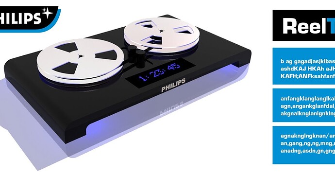

I made this with that foam and wrap it in vinyl. The reels I bought on the market for 2 euro. I used markers on the cork in the middle not good idea hehe. But I added LED for realism in the screen and the printed with overhead sheet to make the screen.
I needed to wrap the foam first in a layer of paper so you wont see the bubble of the foam. But if i use fillers it would work too. Cause mostly you use fillers you need to sand it all smooth again. Just fillers if its a hard shape that need to be painted and paper for easy shape i can wrap vinyl. I heard you can wrap vinyl on difficult shapes too but havent seen tutorial for it or i need to think of a way to do it myself.
