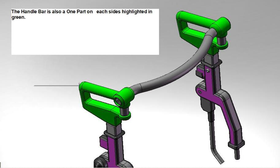

I’m currently working on a college design project which is a walking aid.
I have a few questions regarding the production methods in a few parts of this product shown on the image.
I would say i really lack experience in this, so i need your help.
First of all, my material used in this design is all aluminium but of course they are various types of aluminium out there which i’m quite confuse of but most probably would use aluminium mix alloy.
So in this case, where the picture is shown.

Seems like plastic might be the best bet here. Anyone else feel like Aluminum would be expensive and very heavy at that size?
Hi there,
The reason why i chose aluminium is due to it sustainability and it’s tensile strength, while in actuality aluminium will be very light and stable which is a prerequisite for a walking aid.
Yes,i did consider plastic as well, but from my view is that even though you uses plastic, you still need to build the structure with either metal - either steel, or alu. Then i felt that it would be a waste to cover it with plastic, and the production for plastic molding is more expensive than aluminium casting at the end of the day. :smiley:

  1. Your tube handle would be formed in an NC tube bender as one part including the linear segments at the ends where you are asking about the T shape design. The verticals of the T shape ends would require welding if aluminum, similar to tube joinery on aluminum bicycle frames.
“If this whole connector is a (One Part Bases Design)…” it will not be assemblable into your massive one piece solid handle ends. But you know that, come on, how can it get in there?
  1. The Handle Bar is One Part… it’s massive, solid, blocky, has details formed from perpendicular planes which means complex sliding core tooling.
    This looks like a Solidworks design, not a coherent industrial design.
Not to discourage you, but by looking at the design I am wondering if the form is being determined but aesthetic direction or by your abilities in the software. I only say that because, particularly in Solidworks, you see a lot of instances of form being driven by the capabilities of the software or the operator (surfacing difficulties specifically). If so, maybe a small investment of time in surfacing tutorials would be best. I think you will find it will pay off in the long run when you can express your design intent without being limited too much by the software.
As for you handle issue, I assume you are including the T on the aluminum part for torsional stability. Why not use a different cross section for the tube and eliminate the welded section? Besides the assembly problem, I agree that the current handle design is pretty much un-moldable with the un-cored mass near the bottom and the round slide pin needed for the hole for the T part of the handle that has to shutoff against the steel for the gap in between the top of the handle and the bottom portion of the handle. It is technically possible I suppose but unrealistic for production. I would look into simplifying the handle design to be moldable left-to-right, and using a rectangular or oval tube for the crossbar (secured with a fastener of some sort). To reduce mass in the thick areas maybe core out the base plastic and spec a tpe overmold to fill in those gaps (added bonus of making it easier on the user’s hands).

Frankly it looks engineered, not designed. knowing what you know now from a functional point of view, I’d zoom out and revisit the entire thing from an aesthetic point of view, starting with the most general look and feel and moving toward detail resolution.
Its not enough to work well, or look good, it should be both.
It looks, engineered, but really isn’t thought out. Aside from the issue of assembling the cross handlebar to the un-moldable hand grips, the rectangular vertical supports that taper in are also not really manufacturable. If they had a round section, you might be able to swedge them down, but not as two opposite faces of a square section. The big leg with the face highlighted purple is also a mysterious part in that there aren’t many ways to make it. Maybe solid AL? Rotationally molded plastic?
I’d recommend getting a cheap walker and taking it apart, or downloading an instruction manual. The assembly processes are pretty simple. Jam some tubes into some plastic fittings. Jam wheels into the bottom of the tube. Obviously the current crop of this stuff is fairly utilitarian looking and not really pretty, but it works. I’d take a step back, examine the production and assembly processes, and build from there. It really will simplify your design process, ie, making it look good and work well.

It looks, engineered, but really isn’t thought out. Aside from the issue of assembling the cross handlebar to the un-moldable hand grips, > the rectangular vertical supports that taper in are also not really manufacturable. > If they had a round section, you might be able to swedge them down, but not as two opposite faces of a square section. The big leg with the face highlighted purple is also a mysterious part in that there aren’t many ways to make it. Maybe solid AL? Rotationally molded plastic?
No worries Brett, it will not be a taper in which requires knocking & ‘deforming’ the product. ( actually not a taper at all ).
Thanks for your feedback. :smiley:
To all:
(even though it looks impossible & illogical with the T shape connector but no harm thinking for fun).
The reason why i issued the T- connector is because, i thought it will hold the entire handle bar (by welding) without the need of using fasteners. :laughing:
But seriously, i really don’t understand why is it unable to be produce?
Doesn’t it just requires molding? I did get some feedback from some manufacturer on this issue, shouldn’t be a problem at all.
