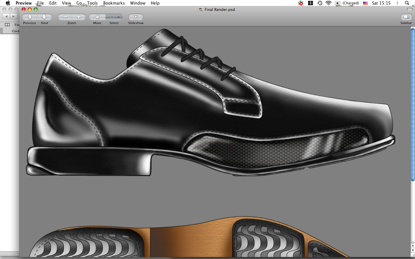

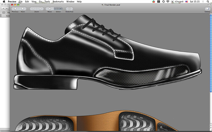

Project: Bond
I will soon be applying for an internship at Nike and I thought designing a shoe for James Bond would help separate me from the pack. I’ve begun the final rendering process and was wondering if I could get some suggestions on improving it. I’m having some issues with rendering the sole, specifically the herringbone patterns in the rubber lugs. All criticism is welcome and appreciated thanks!

Nice thought process but Nike is about sport. I don’t think this will grab people’s attention enough, especially because your design is very subdued.
If you were to do a shoe for Bond, do a training shoe. We see a lot of Bond in action, we don’t see him training. Make a fictitious training routine and develop a collection of 3 shoes for that.

All the advice given by Yo is good. Another thing you might want to consider is to present only what you can show in the drawing. By that I mean, in your description you mention all sorts of fantasy technology (ie. Medial side of left heel hides a lock pick), but don’t show any of it. Either show it, or don’t mention it as it comes of as BS, and doesn’t give your presentation the dose of reality that a brand would want from a designer.
It’s Ok to have crazy stuff in a concept, but just talking about features that you don’t show doesn’t mean anything and is often a negative. If you could show for example how exactly the hidden lock pic tool works, how it is removed, what it looks like, etc, it would be better…

Looks good, a step above the dress shoe you posted earlier.
waaaay better than the rendering! Keep posting more. It’s hard to really comment on a single sketch. let’s see more process, details, etc. the sketchwork is quite good though and much stronger than the flat rendering in both execution and design…
