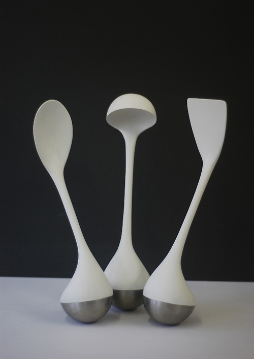

I am looking to design a product that balances on a weighted spherical base. Any help and advice when it comes to using this principle to design a products that uses a weight to keep it in a horizontal position would be amazing! I have attached a photo of kitchen utensils that someone designed as reference, i am looking to achieve the same effect as this fine gentleman =]
I have searched virtually every phase i can come up with any nothing yields results. Any tips and information would be greatly appreciated!

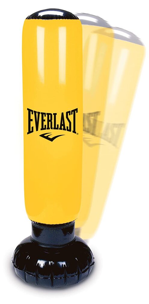

There is the classic clown punching bag.
Or the adultish version:

Hey guys thanks for the info. From the above it seems that if i have half a sphere at the bottom that account for most of the products weight, it should stand vertically upright?
If you’re using a hemisphere as the base, you want the centre of gravity below the halfway line, the lower the better. If you’re using less than a hemisphere, it can be outside of the base, but it must still be in the volume that would be enclosed by the hemisphere if you were to extend it.
It’s not as simple as just making more than half of the weight be in the base, a small weight far away from the line will have the same effect as a large weight close to the line. There are ways to calculate it, but if you’ve got a complex geometry, the best way is really to test it, and put as much weight in the bottom as you can and make the top as light as you can for maximum stability.
