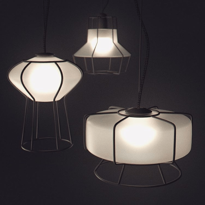

Here are two examples. It just seems like it is a film filter on top.

Using that amount of noise in any professional design studio is unacceptable, unless the effect is very strikingly done.
It gives an illustrative effect which is nice for internal presentations to other designers or artists, but clients actually want to see popping renders that communicate well, not so much artistic ones.
In some occasions, say vehicle renders, you can use a film grain.
Sometimes a computer render looks very CG-like because in reality the brain receives a higher variation in lighting details.
For example, renders often either look cold or warm while in reality there is always a balance.
What you can do to increase the perceived information is add a slight noise. What I do is 1% noise and then increase the highlight levels overall (from 255 to 242) so the background remains a pure white.

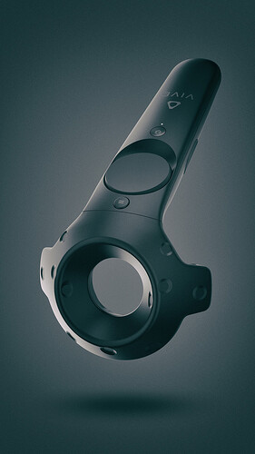

Here’s an example of render that look like the noise was intentionally added. Or it could have been only been added to the background to better match the textured plastic? Regardless, I’ve seen this trend more and more over the past couple years, especially in portfolios of newer designers.

In the lamp example it looks like it is intentionally done in post processing (photoshop) to take off the too-polished look renders can have.
As has been mentioned above it is not something that would be sent to or shown to clients.

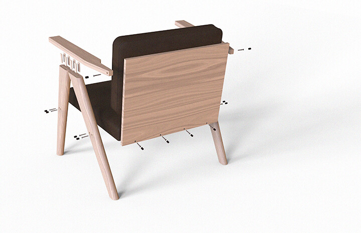

I just did a quick render of a chair I designed a while ago to see the difference between adding noise vs. no noise. I can totally see how it gets rid of the “too polished” look of the render and sort of helps to hide the crimes of some small mistakes.

The comparison of noise vs. no noise is a good example, you can see it adds a more realistic and warmer touch.
For a better effect, use slightly less (-0.25/0.5%) noise and whiten the background more so it becomes cleaner.
The best thing to do instead of noise is making materials more realistic with a slight bump and specular texture especially on wood and an added opacity texture for fabrics. Then what I do sometimes, a little Spielbergian, is adding a warm light panel on the side where light hits from the top, and a blue/purple one where the drop shadow is. See an example of my recent project here: Comodo Visualisation | IDZone
I find these colored side fill lights very effective. You can also spot the 1% noise here!
However for quick and dirty concept renders that have to be done in a few hours, including the CAD work, only adding that bit of noise is a way to improve workflow.
