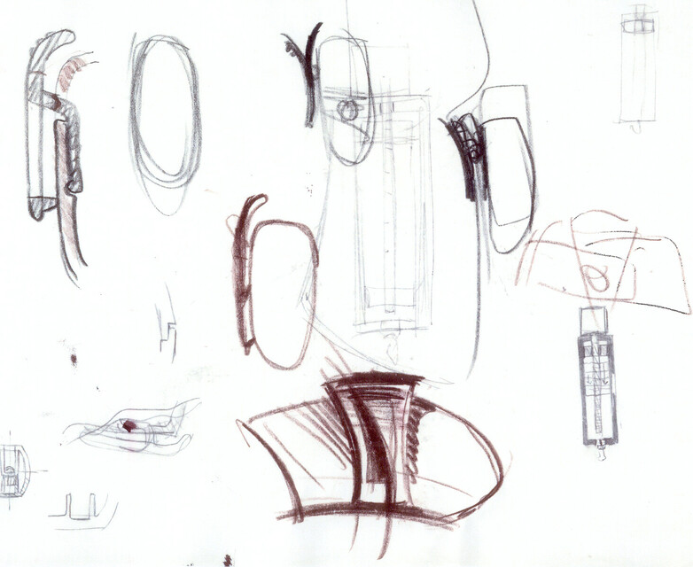

I agree with that they should probably be re-sketched. I have attached some that are similar to what you are showing. These are not what I would really consider a sketch, more of me getting some thought on paper and thinking out a problem. I then take these thoughts and translate them into more well thought out sketches. This was from an insulin pump design for teenage kids. I was working through the form and how the internal components were going to fit and also how the clip would work. You will find when you start working that these will be the kind of sketches that will be on a white board or a flip chart.

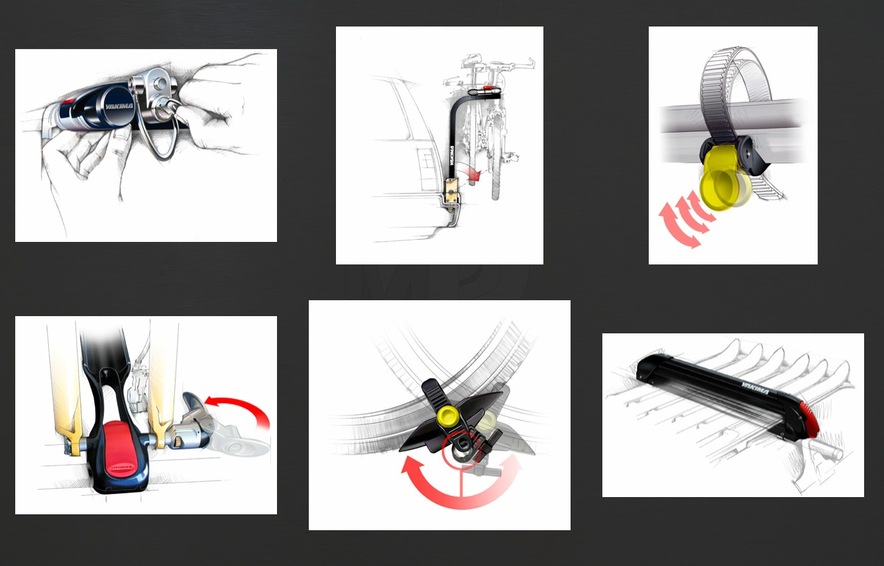

like this. go.

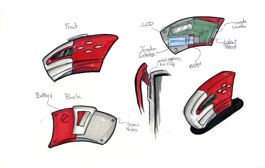

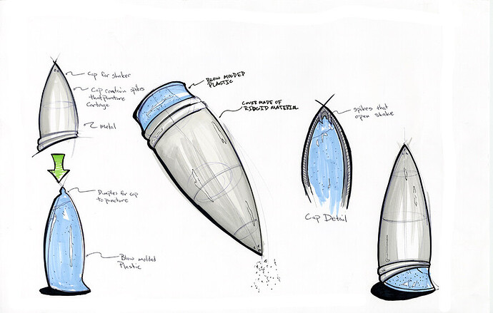

These are some sketches that came from those “thoughts on paper”. I also included one from a salt and pepper project. You will notice that these are influenced by those doodles and I created an informative sketch about the inter workings of the product.
