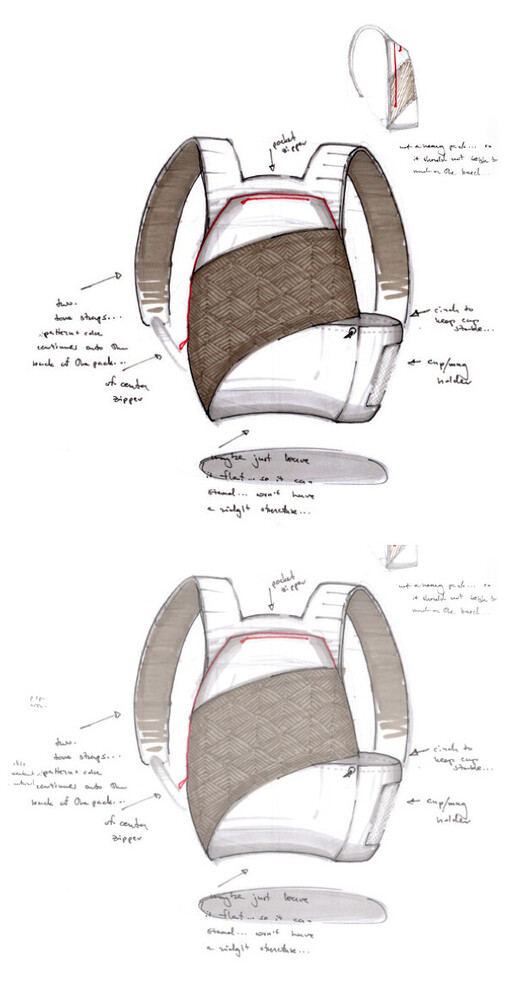

I really liked some of the sketches for Bodum project, you had some nice little details and texturing that I think was completely lost because it was so faint. I’d take them back into photoshop and level them up so that there’s more contrast.
Also if you still have the prototype of the bag I’d take some nice studio style pictures of just the bag, look at some reference of how softgoods are typically presented and try to copy that. Seeing it in context of use is great but I was hoping for a money shot so that I could see how the final design was resolved.

im gonna pump up the sketches for sure now…thats a nice comparison up there…sadly the bag is in storage somewhere and am worried about its current status but i will try to get it, thanks for that shooting suggestion…
