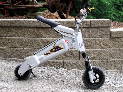

You could change the bus to accommodate your bike, or you may also change your bike.

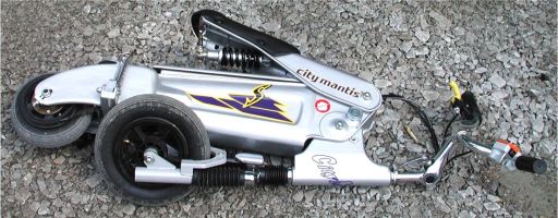

Perhaps this might solve your issue:
It’s a great deal smaller than a traditional bicycle, especially when folded, and can top out at 16mph. Also, you wouldn’t need to buy a lock for it since you can just bring it with and let it charge next to your desk where your cellphone might also be charging.
I think many of our transportation problems can be addressed by choosing something that fits your needs first. I would definitely get a Mantis, but that’s just me since from a cost perspective, my investment would save several thousands of dollars in modifying a bus to pack in more bicycles.
Except then you have another issue to deal with: You look like a dork. :wink:

I’m going to agree with Richard. The Mantis will repulse most males at the very least. This is a design problem. A product only has one chance to make a first impression!
Another problem is that it is a scooter. If my commute is longer than a few blocks, I want a real bike.

“The mantis bike suffers from a poor balance of form and proportion. Specifically, the wheels, the most important physical element of a transportation device are very small compared to the frame and rider, which give it a weak visual presence and one of instability and toy-like qualities. Compared in size to the rider, these small wheels look slow, unstable and inefficient, all not good qualities. In addition the tiny handlebars (the main control interface for the bike) are also ill-proportioned and styled, looking like they came off a cheap 15 year old lady bike, which further adds to the odd and non-cohesive look of the design.”

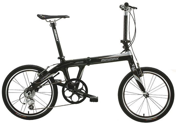

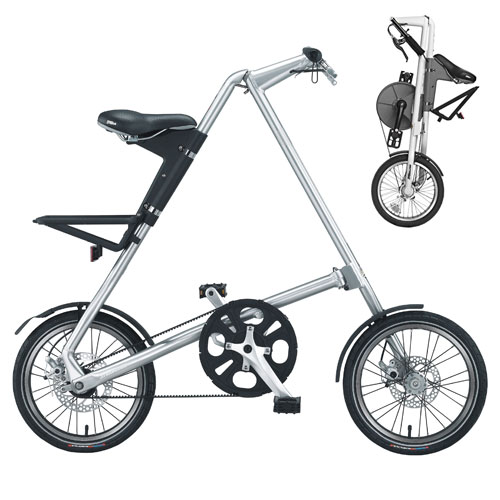

As for solutions where the bike is taken into the bus, there are fold-up bikes as well…

I know people do it, but riding those little wheel’d folding bikes
when you’re 6’5" is ridiculous to say the least.

A folding bicycle is probably the easiest solution, but I would rather just keep riding my bike and skip the bus.
