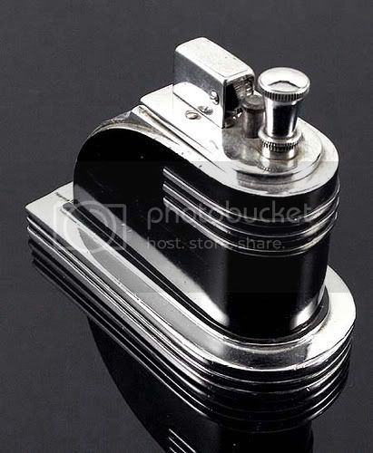

  • Where does this product go? Is the aesthetic contextually-appropriate? (Art-deco isn’t a very popular interior-design trend these days! Can you show us a photo of an ‘ideal environment’ this would match with?)
