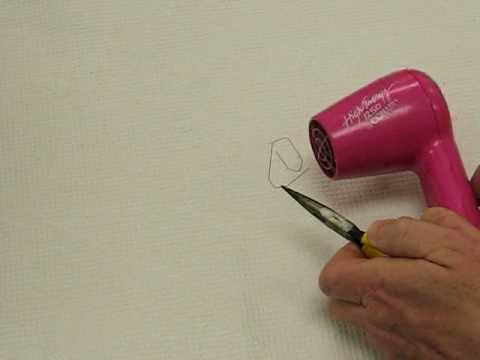

Something else thats on the horizon is memory materials, though there arent many products using it. Some go from one shape to another by temperature, sometimes with a small electric charge. these examples are metal, but some plastics will do it too
