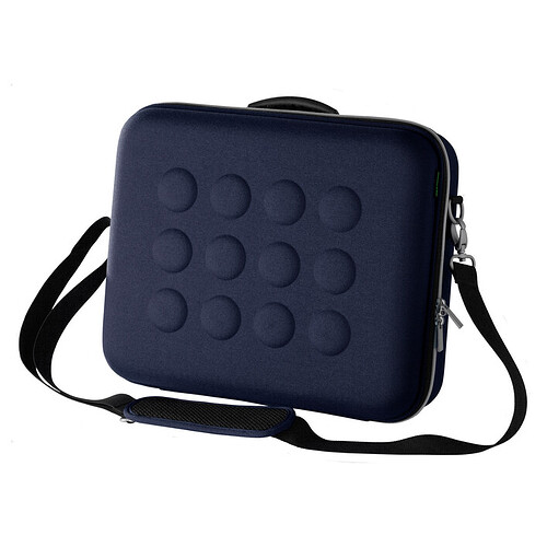

Hello everyone,
I’m wondering if anyone knows any of the specifics of the outside fabric material on this case from IKEA. The listing says it is polyester, but are there particular properties that allow it to be deformed permanently (the front bumps and the round edges) while still maintaining the weave of the fabric? Any suggestions of physical properties or specific fabrics would be very helpful…
You can zoom in on the image here: Products - IKEA
Thanks!
That is a heat formed case. The fabric is pressed into a negative mold and steamed / heated and then usually spray sealed as well. It’s a great solution for small volume containers that require light weight but a relatively soft demeanor with durable surfaces. You can most often provide 2D views as a pattern or also provide a 3D data model (but many sew shops won’t use it for anything more than guidance).
Sometimes used in conjunction with and referred to as ‘formed EVA’, there are several common materials used and many manufacturers in the Far East. If you’re looking for a shop for costing / sampling / production, feel free to email me - I can put you in touch with a good one. Consider spec’ing an edge-band and/or a zipper closure if appropriate for your designs, it finishes the edges and makes for a nicely refined appearance.
Thanks! Sending you an email now…
I would describe this case as thermoformed EVA with a poly jersey outer. The jersey is adhered to the EVA before molding into the final form. I agree with the post above that the edges should be finished with binding because it will help prevent the outer fabric from de-laminating through use and give a clean appearance.
Many other outer fabrics can be used to cover the EVA. Lycra is generally more expensive than poly jersey, but gives a neoprene-like look. Other polyesters work well too - you can play with textures to create an appearance that is coarse and rugged, or smooth and easy to clean.
In terms of creating a tech pack for your design, I have worked with suppliers in China that do not have 3D software and prefer 2D dimensioned ortho and section views, where others have asked for a 3D file.
