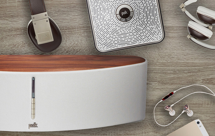

I’ve been meaning to post this for a couple of months but I just never found the time to go through the records and pull together the files. This is one I’ve been working on for the last two years and included ethnographic research, segmentation, strategy, branding, product configuration, building a design language, product design, packaging, art direction, model selection, working with ad agencies… I think the saying is ‘soup to nuts’. In addition to directing, I dot to work hands on with three of the 6 products (with a designer assisting me in each case to do the heavy lifting, I don’t have the time to really do the documentation work I used to… bitter sweet, sometimes I miss the days when I could spend hours on a CMF spec! But doing all this is fun too!)
Anyway, I wanted to share it. The goal was to take brand that had 40+ years of history and expertise in making awesome home audio and get them into the personal audio categories of headphones, bluetooth speakers, and airplay speakers in a way that was authentic to the brand, meaningful to the user, and impactful to the business.
We wanted the design language to communicate this sense of history, expertise, and craft. The language is organic and the material pallet is very warm, lots of real wood (mahogany in this case), leathers, gold plated metals… all of which have challenges in working with. We call the aspirational persona of the brand “The Devote”, very much a craft oriented person, with a passion for music and how it sounds. Each product has an innovative idea behind it that centers around acoustic performance. For example:

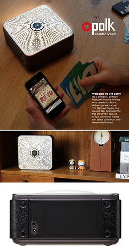

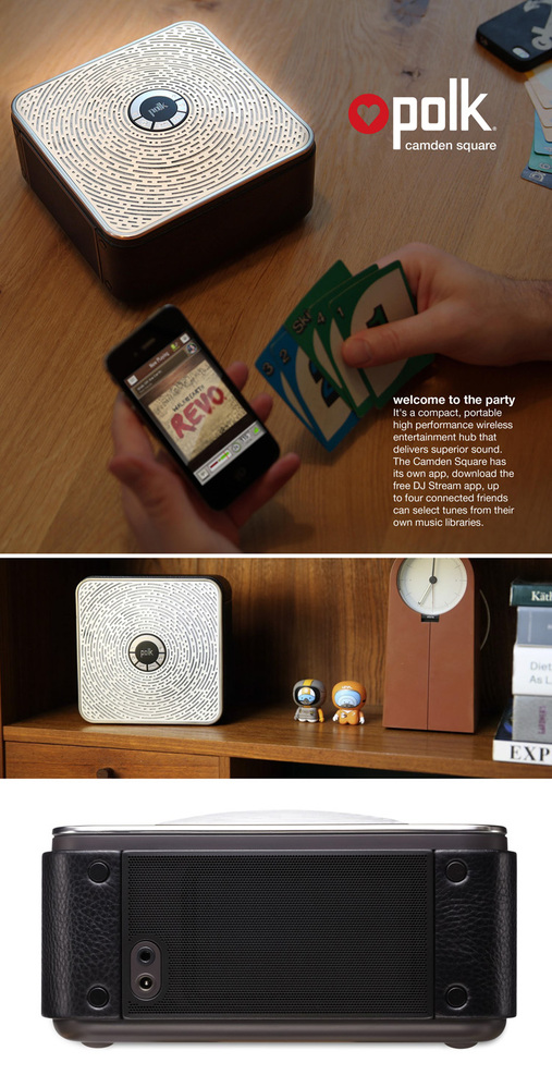

The Camden Sq: I didn’t work on the ID of this, but I did work a lot on the Ux. It was designed by one of the Sr guys at frog, coincidentally the same guy that designed the original Beats Studios, Francois Nguyen. Here the innovation is centered around sharing. 4 phones can connect, which is neat, but the cooler thing is that with an app all 4 phones can create a shared playlist that is stored in the cloud. the cloud then pings each phone and tells each one when to play what song to the device. Up to 125 other people can be logged into the play list and they can up vote or down vote songs allowing the 4 DJs to accumulate points. The top is that shale because there are 4 drivers all pointed at 10 degree off axis angles in a L/R/L/R patented arrangement. The net effect is that when the speaker is placed in the center of say a picnic table, no matter where you are you get a stereo experience. The battery also lasts for 24 hours of playback at real volumes.

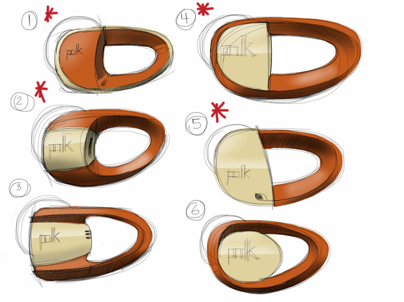

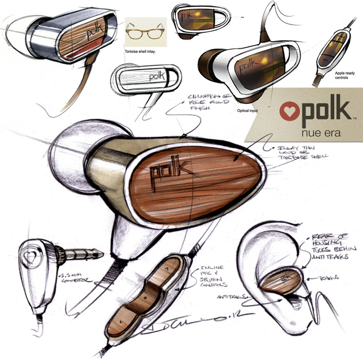

The Nue Era and Nue Voe: These I worked a lot on and even dug up the early sketches. Both are tortoise shell and gold (some of the original sketches show wood inlay but it proved difficult). The concept was to create something that felt more like cufflinks or eye ware than a piece of consumer electronics. The oblong shape is designed to tuck behind your anti-tragus (that part of year ear just above your earlobe). This does two things; first it prevents them from falling out and distributes that task across a larger surface of the ear to minimize any point pressure, second it releases pressure off the ear tip flange and allows that to maintain a proper seal. A proper seal means more bass response, so the headphone doesn’t need to have the bass artificially jacked up, making it a more pure sound. The Nue Voe uses a super high end and accurate dynamic balance driver. I worked with Ken Chae on these as well along with some awesome engineers at both frog and Polk.

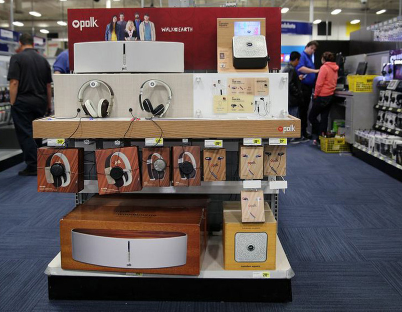

Not to mention in store displays… OK I’ll stop :slight_smile: This is why I resisted posting this earlier!
Display video explaining the concept for the Camden Sq.

Yeah I was in Best Buy a few days ago and saw all the Polk Stuff. It had a good presence inside the store, and sales associate pushed the Camden pretty well. Cool to know Francois designed it. Always a cool feeling to personally know the designers behind products.

The Camden seems like a modernised muji CD player to me which is a good thing.

Did you guys develop the concept of utilising the anti-tragus as the “anchor”? I haven’t shopped for headphones in a while, but last I saw most were using the anti-helix as support. Are you hitting a percentile range for the sizing? I interviewed at a startup a week or so ago that were looking to 3D print custom inserts, again using the anti-helix, it would be awesome if using the anti-tragus could solve the problem entirely!

I love the concept behind the camden sq. (& its video.)

@mas2, I can definitely see that. The pictures don’t do the grille justice, the cross section there is a like a very shallow bell curve.
@Michael, I had an older pair of earphones that utilized the anti-tragus, but they didn’t fit quit right in a wide enough variety of ears. We cast and scanned a huge number of ears in our shop when we started designing headphones and earphones. We probably have one of the larger sets of data around ear shapes. and we found this to fit better and easier. The anti-helix solutions seem more polarizing. On the Woodbourne, our acoustic engineers don’t seem caught up in the golden ratio, cross section is more important to them in dealing with internal standing waves.

I was curious as to how you guys handles the multitude of ear sizes for the headphones. I knwo that I could not wear the same ones as my wife. What material is the piece? I assume it is some sort of hard plastic. Did you guys consider any malleable materials that could deform a little bit to contour to the ear?

@ Yo - the Camden Square arrived in the studio a few weeks ago and is sitting out front with the rest of the line. The build quality is really nice and the materials translated well from concept to production. Haven’t had a chance to turn it on, but I’m sure it sounds great!

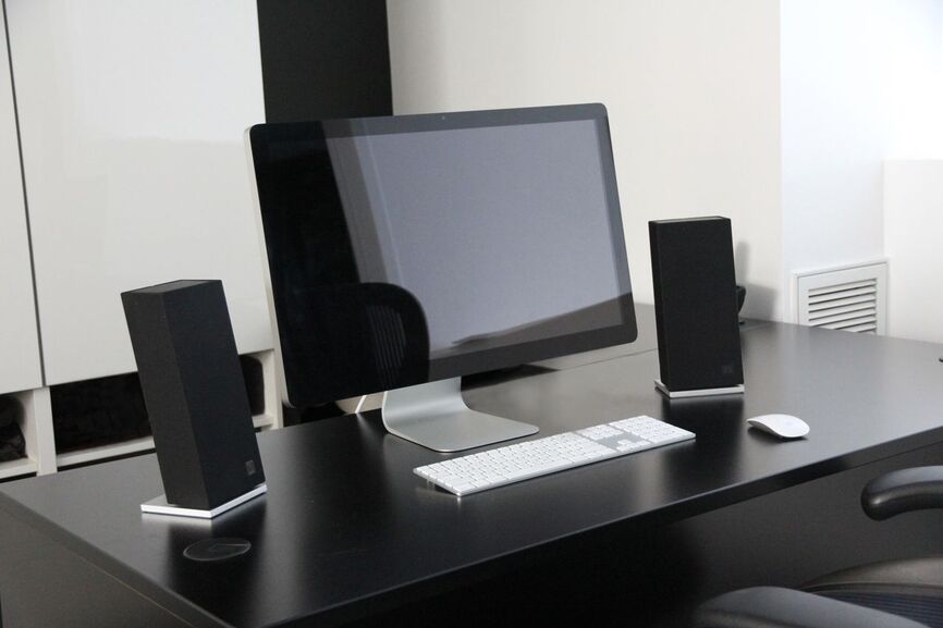

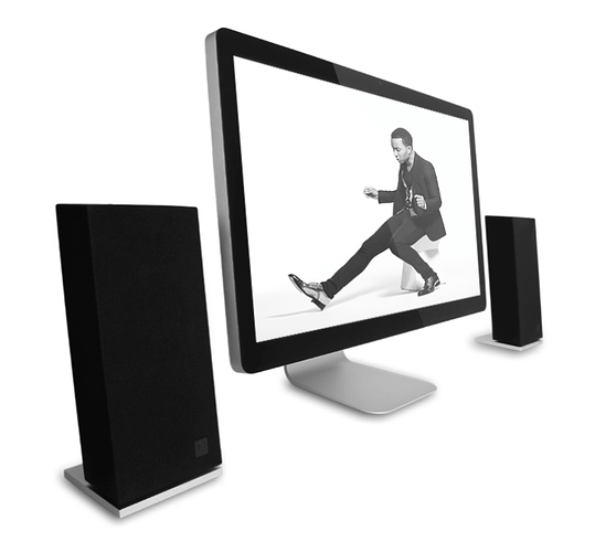

In the mean time, if you wanted something from our premium brand Definitive, we just launched these. Machined aluminum bases, bi-polar sonics, super loud and the sonic reproduction is amazing. The Definitive voicing is a little more of true to studio sound, so it sounds a little crisper and colder than the Polk sound.
Cameron Nielsen, who also posts on here quite a bit, worked on these along with Luke Saule from frog.
You could also get the Camden Sq, it has an Aux in in addition to BlueTooth.

I take exception to the Camden square design. In audio world the Apple popularized slab-brick with radiused corners is so overdone as to be creatively bankrupt or outright copying. You want a list of 20 - 30 companies making various audio equipment with this design style? Awhile ago I was commissioned to write article during Apple-Samsung lawsuit and I chose this topic, the gross overuse unto exact copying of Macmini design style (not published, magazine decided otherwise). Of course, Apple doesn’t own this style, the first to use this shape in audio was Werner Panton in 1963.
Pier, I’m a bit biased, but I am honestly surprised you’re having trouble seeing all the originality in the Camden Square. What other wireless speaker has a contoured metal grille with unique record groove perf, and on top of that metal grilles on the sides along with leather and rivets? This is worlds apart from the Mac Mini form factor or any wireless speaker I’ve seen recently.
I think it is one of those things you just need to see in person.
The bell curve dome of the grille reads a lot more in person as does the brown leather and gold metallic.
