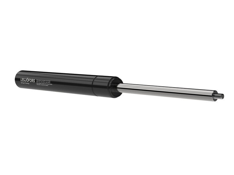

I am a freelance IDer and doing an interest project; I have to creating a movement similar to the anglepoise lamp, but am investigating using pneumatic hinges instead of springs. However I am having a hard time finding information or suppliers to talk to. Does anyone have any knowledge on pneumatic hinges/joints or springs for that matter?

i would think more about the movement you are are trying to achieve and then what tool might be the solution. A pneumatic hinge may end up being more complicated ( usually a lot more resistance and slower to move) than a spring or friction fit pivot…
go look at some things with pneumatics or gas springs and see how they work and if they are performing as you’d like…
Cheers FloatingHead
I have been looking at the other products, however it is as much the range of movement that it can deliver as well. I am needing it to hold about 3kgs where the lamp head would be and was unsure if springs could hold that weight which is why I was thinking towards the pneumatic/gas springs.
For it to be able to be moved with ease then frozen in the desired place.
mechanical springs are stronger than gas springs.
Friction and the like maybe a cheaper and easier bet. Rotatory mechanical springy springs may work.
Would think that linear metal springs are cheaper and more reliable than pneumatics but have a much less good “feel”. Mechanical springs can be cheaply and easily made to spec by most suppliers. Need to spec material and dimensions which is an easy calculation but have lots of options.

Pneumatics will use a penumatic piston with non-return valves. I think you will get what you pay for in terms of gas leakage (i.e. how long before readjustment). Similar inputs i.e. how springy, what feeling you want to create
Alot of it depends on the “feel” you want and results that you expect. A well designed gas, metal, friction fixation will work better than less well design one (which is duh when you write it). By that i mean that a cheap friction clamp well done, is better than a pricy but thrown together gas spring.
