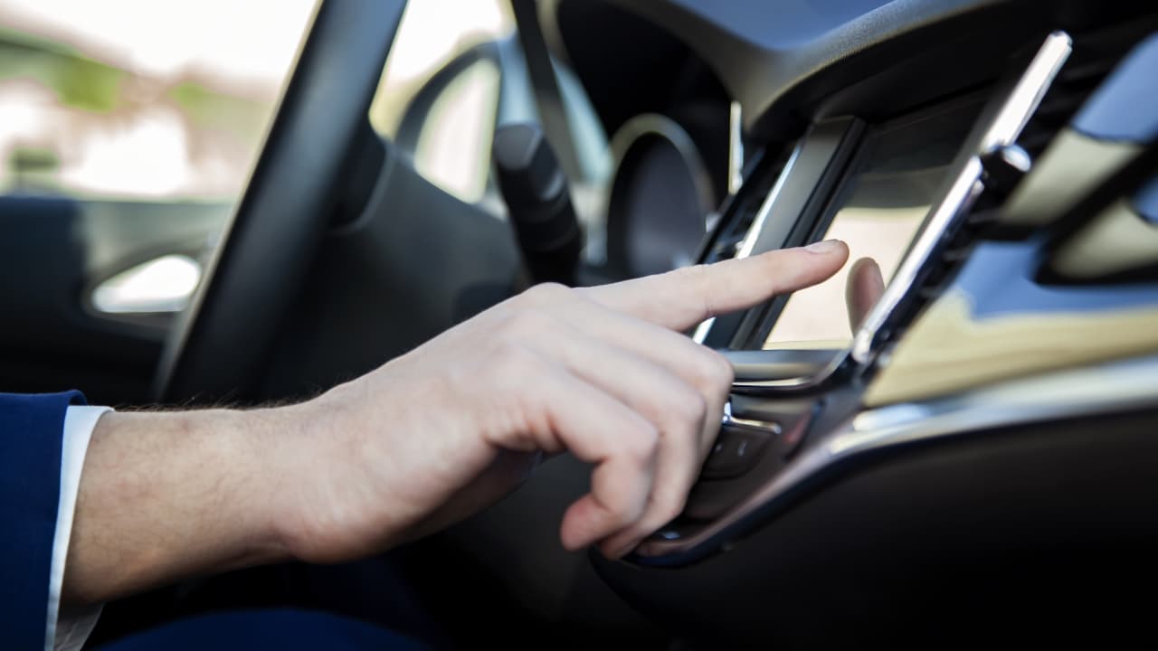

Kinda misguided to blame it on designers for wanting a clean look. Saving this study for future reference when a client wants to replace physical HMI with a touchscreen
I’d venture the problem is not touch-vs-button, but the possibility of layering and hiding controls in favor of reducing clutter. If we would have all AC controls under a lid that you had to open first we would have less clutter but same UX issue as the touchscreen. (ignoring haptic feedback and signal response which can be assumed to be equal (but rarely are)).
The advantage of a physical button is that it is in the same place each time it’s needed. If you know where it is through repeated use, muscle memory pretty much gets you there without thinking or looking. Clean is nice, but I’m in the physical button camp.

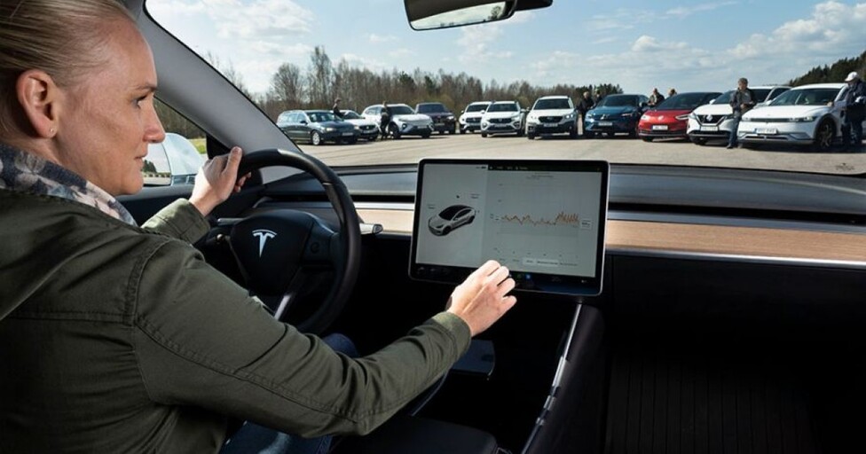

As a Tesla Model 3 user and industrial designer I do root for the study and the substantial argumentation pro button so far. Had thought of “inventing” buttons, that attach at the bottom of the monitor for the model 3, but after some research found, that there already are aftermarket products catering to this.
“amazon: Enhance S3XY Buttons for Tesla - 6 Black”
(Sorry you can’t but links in your post) says the new board. / Really?
I would love to have a better integration into the given layout of the cockpit, but it shows “proof of concept”. Does it sell? I dunno. Tesla drivers tend to be a little stubborn in being different. Even at times it borders on dangerously wrong…
