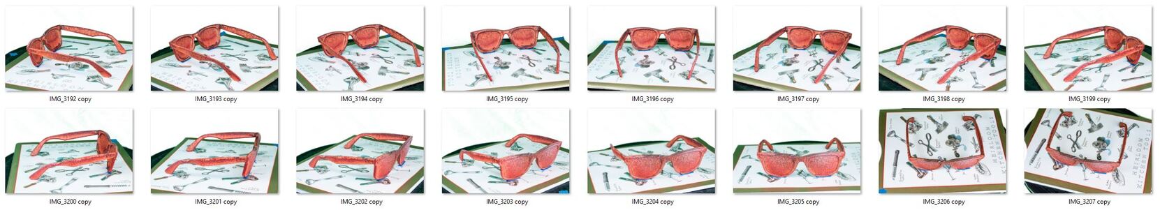

Photogrametry software doesn’t work on glossy or transparent objects. It also needs lots of small details for the software to reference.
I’ve found it works best when I spay the parts with a washable chalk spay and then use a toothbrush to create splatters.

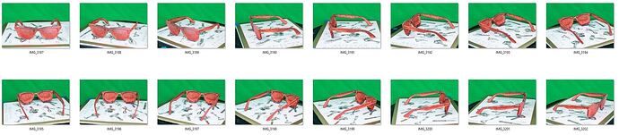

You should be able to walk around your object to take photos, however I got the best results when I shot the object on a green screen with a turntable.
Photogrametry software expects to see the background move with each change in angle. The creases in the green screen will mess up the software so
I used a Photoshop batch command to delete the green screen in my photos.
