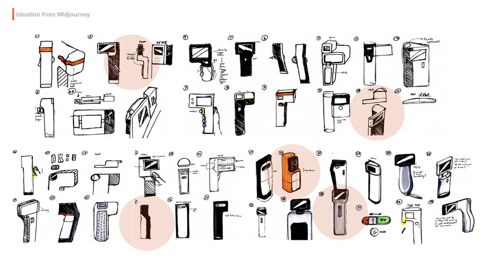

  1. AI form exploration… does this add anything? Did you need AI to tell you to make a rectangle with rounded corners? As the hiring manager should I just not hire a junior designer and use midjourney myself then?(Sorry to be so blunt, but these are the kinds of questions a creative director might ask, I’ve gotten some pretty difficult questions over the years, sometimes they just try to throw you off).
  1. Are those your rough sketches? They are labeled as mid journey?

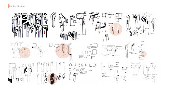

  1. Ideation sketches…. I had to scroll a long way to finally see your design work

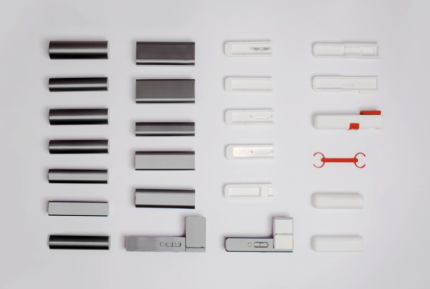

  1. Little sketch models are great. Usually when we make sketch models like this there will be much more variety. Prototype different things vs 20 versions of the same thing.

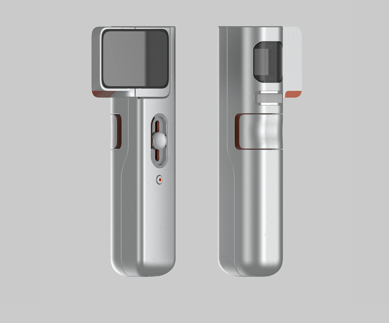

  3. Final renders…. All the dust and scratches… yikes! As a creative director I wold not be able to show any of these to a client or if I was in house having to present to sales and marketing, they would just find all of that so distracting. We are not trying to make it look real, we are trying to make it look better than real. We are focussing on communicating the idea of the product, not fooling someone into believing it is real, save that for the marketing renders that will happen 10 months later.

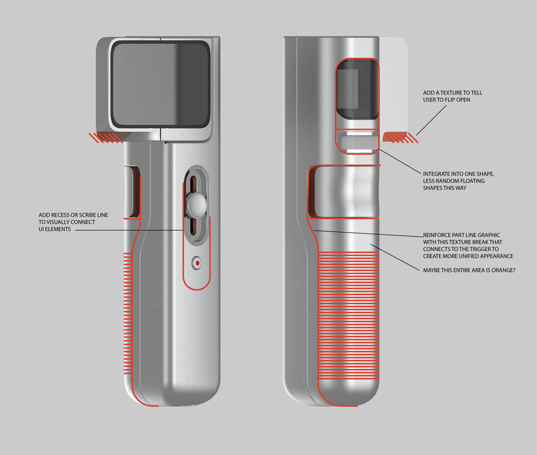

  4. Overall the product looks very slippery and seems to be missing the kinds of textures and grips that would make it feel safer and more pleasant. When something is this simple, every detail matters a lot, I’d make the radii on the lens and the flash (?) below it match up or integrate them so they talk to each other more. How about a lanyard so someone can secure this to their wrist? Pretty standard in the camera world.

  1. In ideation, I want to see variety. I want to see that a designer can create a ton of solutions and provide options to discuss and discern as a team. I worry a bit if it appears like their first idea was the only thing considered. What if it twists, or you squeeze, or you pinch, or you steer with a finger joystick, or what if______. You might stick with this slider but can you think beyond?

I would add to those points, two things. 3) Sketching details could improve and/or at least get larger so I can see what your thoughts are. Maybe this solves the ideation feedback from earlier! Maybe you did think about a bunch of solutions and we are just missing it :slight_smile: 4) This is graphically nitpicky, but can it please read like a website vs a book forced onto a website?

When showing Midjourney, like other explorations, give us some context, what were you exploring, what were you trying to understand, what were your prompts, how did you filter or evaluate outputs, did that impact later inputs, did you make any interesting/surprising learnings, etc… I HATE when aspects of process are presented like a box being checked and no more. Tell why you did it, tell us what you did, tell us what you learned.

Many of the details (the slide to zoome in particuluar) seem to large and unrefined for the level of execution you are looking for in the folding display. The front of the handle is really lacking in humanity for me, it looks like what a machinist would arrive at, and not in a good way.
The scratches are fairly unrealistic, probably not representative, and distract more than they add, get rid of them.
