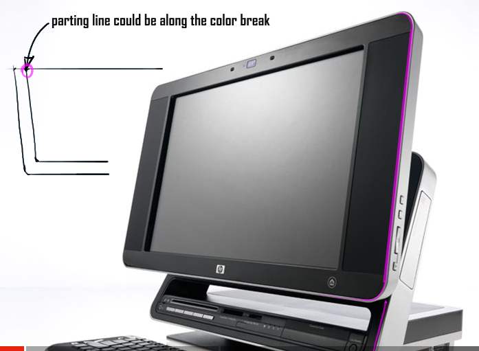

I was looking at Teague’s new website today and something struck me about the computer they designed and is their current showcase project.
Have a look at the attached image which is a screen capture from their site.
What it seems to show is a part that, by old-school thought processes, is a no-go. There is a radius on all corners of the cross section.
Now, while this isn’t the part that confuses me so much. You can achieve that through a stepped part line. Toolmakers grumble about it, it costs a bit more, etc…but it is achieveable.
What does confuse me is that there is no flashing where I would anticipate the partline to be.
Now, I anticpate this part is injection molded and then painted. But even with a good coat of paint, I would expect to see a faint flash line.
Am I just following too old school notions of parting lines and finishing, or is there some kind of hocus pocus occurring here? Did they do some kind of polishing out of any flash partlines? Can the paint be applied thick enough to not show flash lines?
Or is this ID showing an ideal design and not the reality of the final product?
I am not picking on Teague for this…I see it all over the place and my first boss stuffed “good tool design” techniques in my ear till they bled. I would actually like to eliminate some of those “good tool design” laws he taught me with updated ones if they exist.

ip_, it’s always possible that its a model but in any case it is not a problem. The two edge radii in the direction of pull are no problem of course and there may not be a radius on the back or more than likely it’s very small, maybe less than .015 in. It’s also possible that there is just a little hand work done on that edge prior to paint.

The four sides of the part could be made on sliders, then standard core/cavity for the inside and back sections, so the part-line would be on the inside edge after the radius. If you look just above the section line you drew, you can see a recess which would have to be made on a slider…

I hope that I am not misunderstanding the quandary, but couldnt the parting line be along the color break? It could be along the inner fillet radius. That would put the flash lines in less visible area.
I agree with Masterblaster–that’s exactly where I’d expect it to be. Unfortunately that’s a really nasty place to leave a witness-line.

Looking at the images from Teague’s website I think MB is correct. It also appears (to me anyway) as though the black face stands proud of the edge of the case slightly. This feature combined with the “reveal” between the face and case, and the witness line at the bottom of the radius probably conceals it to a great extend.

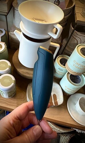

I do love an interesting part line. Nice little jog in the part line of this mixer I spotted while shopping up on Alberta St in Portland today.
The groove always stayed ‘west’ of the actual part line in that image, didn’t it? And assuming it’s silicone (which I’ve done zero parts in), there can be small undercuts in the tool, pullable with no problem.
Apropos the earlier thread messages… seems like they haven’t aged well. Manufacturing (and perhaps design) have figured it out.
@slippyfish yah, you can see where the parting line continues away from the groove at the top. I didn’t study it that closely, but it seemed like silicone over top of a hard part so it must have been a core that went inside to get the undercut of the through hole for the top push button.
Impressive for a cheap milk frother.
