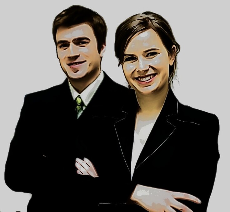

Well I gave it a quick 10min whack at it in PS. meh… not quite there. I think a combination of these plus some quick pen tool outlining lines and you can pretty much get that look
First one is stock image
no.2 Filter>Artistic>Posterize
no.3 Filter>Artistic>Cut Out
no.4 is no.2 set to “Multiply” on top of no.3 with a brush stroke on her chin
no.5 no.2 with a cream color layer ontop set to “saturation”

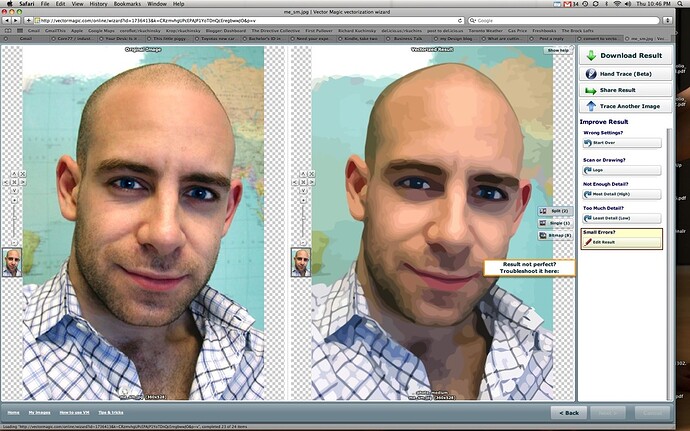

There’s also this, online version of a similar app-
attached is a screen grab of the result. works pretty good, plus you can adjust for more or less detail. the pic below is medium detail. zoom the pic to see it better.
plus i think there are several different sites that do this. google “convert to vector” and i’m sure you’ll find some plus other tips to use in PS/Illustrator.

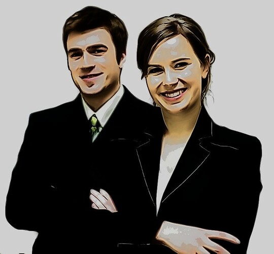

forgot to post this last one, used the paint daubs and posterize filter and a touch of blur. I saved the actions as a script.
