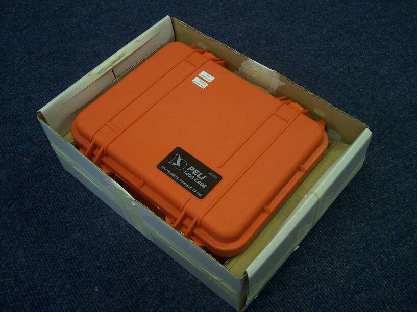

Don’t worry about the tape. That is how you get your thoughts out esspecially if this is your first time designing packaging. My suggestion is that you have your suppliers come in and help you. By the pictures you posted there is not a lot of information in what you are trying to accomplish. From these pics we don’t know how the product is going to be shipped, is it palletize, how is it displayed, were is it sold, and most of all how is it packed. These are key points when designing packaging. If you can get the answers to the points it will help you in the direction that you need to go and what supplier will be best to use.

here is the email i sent out, i attatched those photos above and some technical drawings aswell
to be honest i think its the order quantitys we want that are putting people off, but there are companies that sell far less, and they manage to get bespoke packaging manufactured
