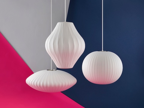

It’s not mentioned anywhere, but I also find it very interesting that there’s a lot of parallels to the production process and story of the George Nelson Bubble Lamp by Herman Miller.
"Nelson was inspired by a set of silk-covered Swedish hanging lamps that he wanted to acquire for his office, but he found the price to be prohibitive. An ingenious and resourceful designer, he went on to create the first set of Nelson Bubble Lamps using a translucent white plastic spray, a technique developed by the U.S. military at the time.
A seemingly unrelated reference soon led to an intuitive idea. He recalled, “It was a picture in the New York Times some weeks before which showed Liberty ships being mothballed by having the decks covered with netting and then being sprayed with a self webbing plastic.” Nelson located the manufacturer of this resinous plastic and used it in the making of the bubble lamps."
