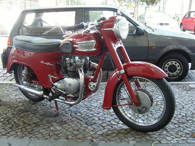

FWIW, I saw this bike while traveling in Berlin, so figured I post a pic, perhaps for some additional inspiration/love.
Triumph Speed Twin… … totally cool old iron… . spooge, spooge, gush. … :blush:
Here’s another one :wink:

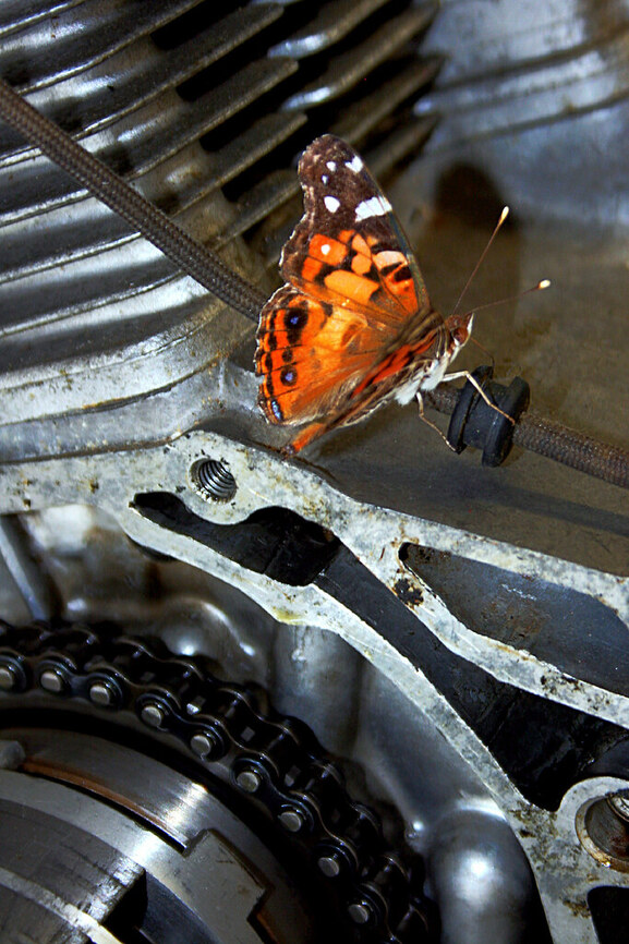

I’ve been insanely busy the past couple days (stupid marketing mid-term, finance paper and innovation meetings!). I did manage a few hours today to polish this piece. I also had some company from a little butterfly, who hungout right next to me the whole time.
a shop butterfly … totally appropriate I’d say.
