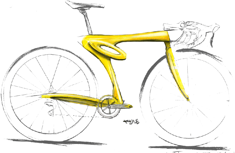

hey just trying to refine this concept a bit. The O looks clunky not too sure how to really pair it down.
Any feed back or crit would be great thanks!
The bar that connects the rear wheel to the pedals and the rest of the frame might work well as an elongated O. The fork might also be able to be sculpted to look like an O from the front. Also, those bike seats with cut-outs that are designed to protect your fertility sort of look like the Oakley O as well. Are you thinking of making this frame out of aluminum or carbon fiber?
thanks for the input. It’s just a form giving execise for school, so no prodcution. I would assume carbon fiber would be the way to go for thoose organic curves though. just working on a new concept right now… a litttle tighter in the form…should be able to post it soon.
You could do the entire top tube as an “O”…
That would be pretty sweet if the top tube was like an exturded “0” capped at the front and back with reflectors.
I think I would look into ways to make it more funtional, like if you turned its orientation in the position you have it now by 45 degrees, it could be structural.
If it stays decorative, I would make it much smaller so it doesn’t overtake the design and look toy-like.

this type of “S” or “Z” frame has been done so many times now its almost cliche. i would try to use the oakly O more effectively in your design. the color you chose looks really sweet. sketch out a wider variety of configurations and dont get stuck on one idea or concept this early in the game.
As a class exercise, cool looking bike - kinda looks familiar though:

I like the location of the Oakley “O” - very clear branding!

good advice, its just paper afterall.
heh… yeah I agree its the best advice their is. This is probably my hmm… 40th concept /variation on what an oakley bike could look like.
-dnp607
It certainly does. I’m sure as 3fold mentioned this is not a new frame design, their has been countless beam bikes (T-shaped), Z bikes, S frames, and Why?-Frames (Y-frames) but my spin on the idea, even if it’s a bit tired.

I’d ditch the effort to try and bring the logo into the form in such a forced way. Would Nike make a bike as a giant swoosh? Hell no.
Instead, leverage the Oakley “form language” colors, finishes etc.
I think you could bring the stylized “o” into the bike, but it has to “follow function.” Perhaps the handlebars? Crank?
I’d forget the literal translation. It may be something as simple as “o” molded into the frame next to the label. How that could be done might be something of a design feat, don’t think I’ve ever seen any form of comolded graphics or other processes on the tubes, only the standard paintjob logo. Or on the handlebar connector collar, something that’s subtle but you notice when you get up close. Or their concentric “o” look, those lines typically says thin-middle + fat taper near the ends, use that language for the frame. Doesn’t have to scream oakley from a distance, just subtle oakley design clues from a distance that people may not readily recognize, then when paired with the up close inspection, it all makes sense. Good luck.

What if you took the “o” and actually formed it into the frame body itself? Let me explain, since the Oakley o has such a slant, the “o” could actually form the top tube, down tube and seat tube and leave a negative “o” space in the center. The whole front triangle basically becomes and “o” and then you take full advantage of the negative space. Heck, most of a bike is negative space anyway. Just a thought.

People who buy bicycles prefer something that is both strong and light weight. That frame looks like its too flexible to make an efficient machine. Sorry I just cant believe that could be a successful product. Try designing a stem that looks like the O, that might look good with a more conventional frame.
I don’t want to sound like a pervert, but the positioning and angle of the O makes it look like the bike has a big one.
