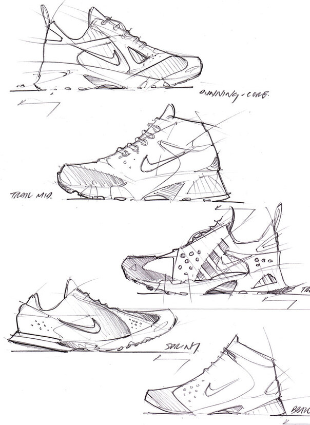

here’s and example of that excercise i just did in about 5 min. based on your upper design. you can see i changed the design just a bit for each type of shoe, and hinted at materials with just some light shading.
hopefully you get the idea.

richard thanks for posting those sketches it really helps to see what an actual working sketch looks like as opposed to always seeing renders or more finished drawings. When you say 5 min for those sketches, do you mean 5 min per sketch?

the sketches i showed were really just quick thumbnails. probably 5-10 minutes for the whole page. i wasnt really looking at the clock.
presonally, i normally start with sketches like these or even more loose. generate a lot of concepts quickly for evaluation. im not one much for rendering. dont have the patience.
