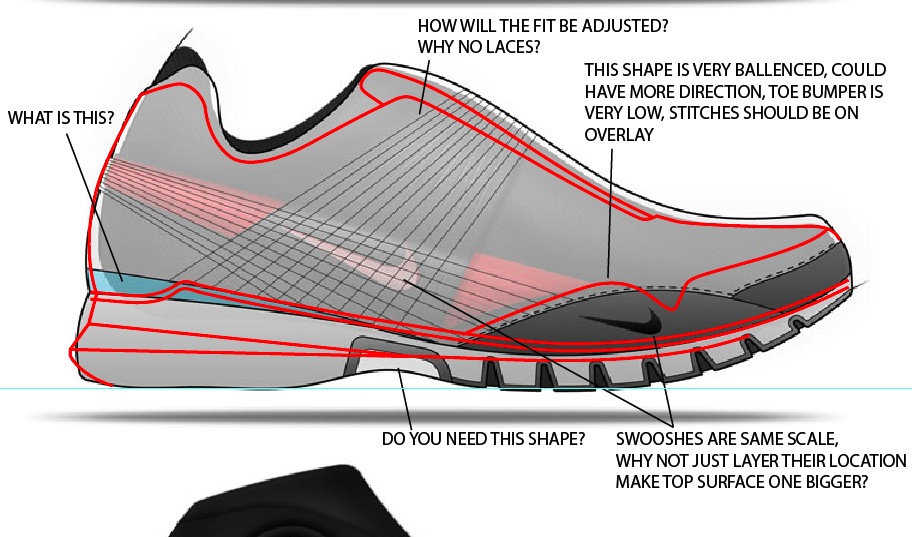

Swoosh always points to the heel. I threw down some thoughts for you, but having trouble uploading them from where I am in China, will try to get them up soon.

You already got some of the stuff I was going to tell you. Here is a quick look. IMPORTANT, this is just a quick thought meant to get you thinking a bit differently, take it and run with it, go somewhere else with it, it’s not a prescription by any means.
I am definitely going to run with it. That looks much sleeker, aggressive, and fast.

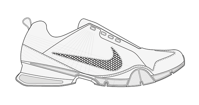

The image below shows the lateral side of the shell with an air bubble in the heel.
Why did it get so complicated?
Have you thought about reducing the overall weight? There is a lot of components that could be simplified.
You have the shell + the inner boot… :open_mouth: Do they both have flywire? Is there a need?
I think the the shell design could be simplified and minimal in design since the main innovation you designed is within the design
of the inner sock, if im right?
Maybe the inner boot could be designed to become the actual shoe without the need of an extra shell, That what i thought you were going for :slight_smile:
Well, I decided to run with an idea and it seemed to turn out more like a shoe than a “shell” In the mean time I have reworked the liners and have thought about literally creating just a “shell” but I feel there will be problems towards the heel for a tight fit.
You bring up a good point flight. Weight is a huge factor in this and all training/running shoes. The flywire is actually only on the outer shell on the inside is a high tenacity yarn similar to the yarn used on the Nike Pro Combat football uniforms.

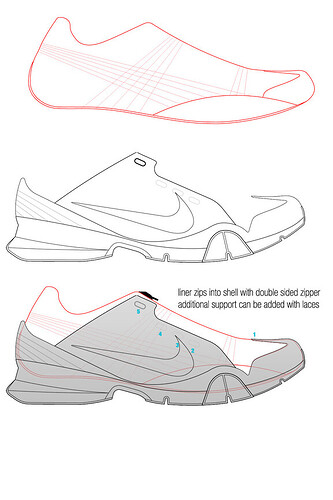

Many track spikes use zippers and many jackets have double sided zippers perhaps the liner zips up similar to a track spike and then zips in to the shell?
I’m going to play around with it a bit.

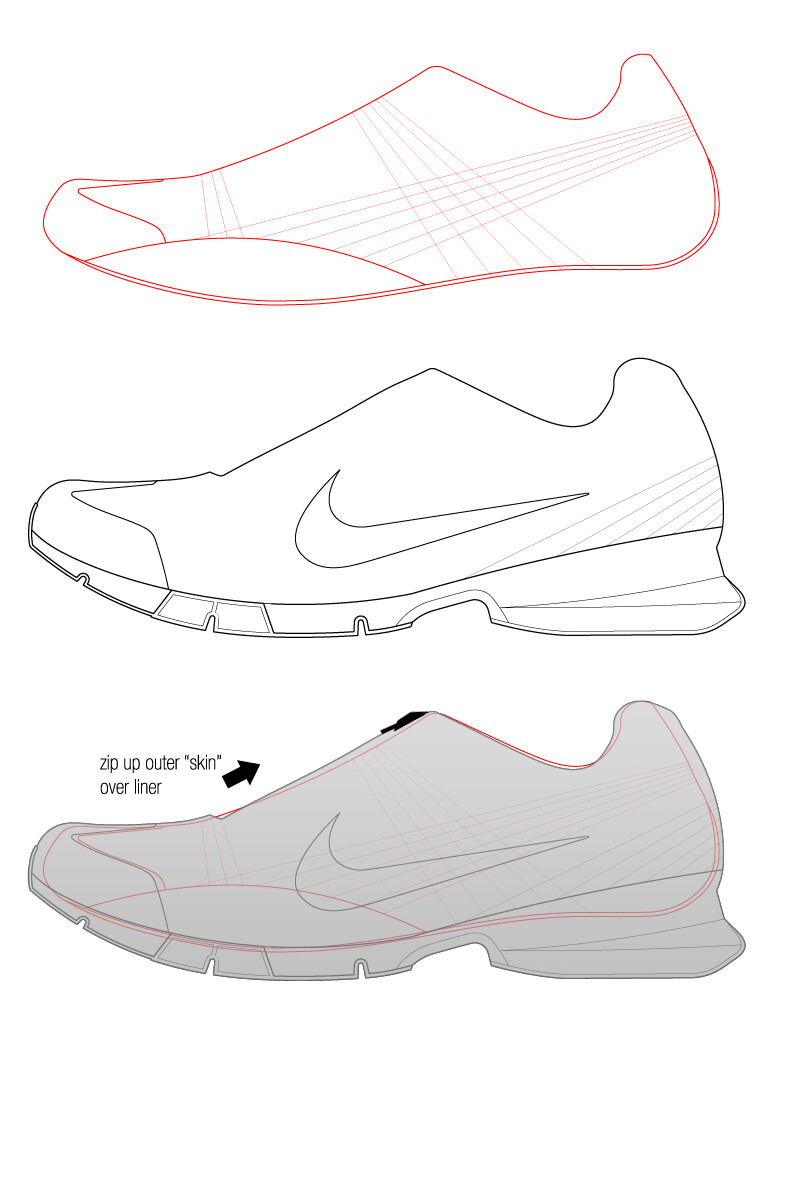

The previous idea I had was to create a stylish trainer while addressing the weight, support, and comfort needs. The concepts below take the same concept and strip it down. They may be a little blue sky, but its worth a shot.
Skin Concept
The concept below allows the liner to slip in and zip up similar to a track spike (ex. Nike Air Zoom Aerofly). Fly wire is added to the heel section for added support and the toe cap allows the liner to fit snug in the front. The sole is made of Lunar Lite Foam, reducing weight and adding comfort.

The second concept uses similar technology such as Lunar Lite and Flywire to help reduce weight, add support and comfort. The Liner would slip into the “shell” and would zip into place (similar to old school roller skates). Additional support may be added with laces.
