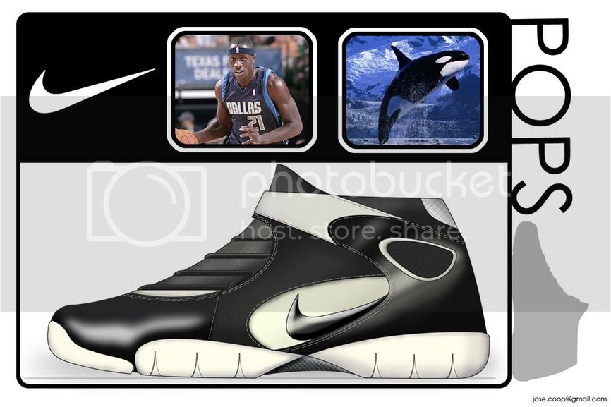

Just looking for some advice and feedback. Just a little project to further my skills. Hopefully you guys can show me where I’m going wrong… I’ll spend the next few days adding other views.
Signature shoe for Pops Mensah Bonsu (Who the hell is that? = Pops Mensah-Bonsu March 06 - YouTube )
I know there’s a whole bunch of players more likley to get themseleves their own line. But he’s a Londoner, and I thought the whole ‘whale killer’ inspiration was pretty cool (Whale killer? = See the youtube link^^^)
Look forward to some feedback, thanks for your time…
The_Boogey_Man: Hi!! I think you should look and find out more about whales and other elements for your design. the proportion of the shoe is good, but try to make all lines flow together. reduce the highlights and make the nike logo comfortable by placing it on the center of your oval shape.
You can find some nikes logo on google and trace it on illustrator, it will make your design better.
I like the way you designed your sole :slight_smile: maybe try to design it so that it will be one piece going all the way around the shoe. Hope it might help you :wink:

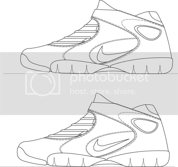

Hows this, I’ve made a few changes. With the Nike logo I was looking at the Air max’s and how the swoosh sort of pokes out…
Anyway, I moved the Nike logo over, and also put it right in the centre like you suggested, is this what you meant? Alo made some changes changing some sharp angular lines and rounding them off a bit.
The image I posted first isn’t final. I’ll be changing bits along the way. I’m going to get working on the sole…
You have a good design, you just need to refine it. if you want you can get rid of the carbon plate exposed on the lateral so that the sole could be design in many ways. the carbon plate you have on the side create a “wall”, a piece that prevent you from designing your sole better. Here is a sketch of what i was talking about, hope it heps
The last one you posted is much better and the nike logo is really working. you can also play a little bit with your outsole design.
outsole and logo are coming along. would be great to see some different, more lose sketch variations of different concepts to see what features you can explore and play with.
also, check your proportion. seems a bit fat in the toe box, and wide in the collar opening.
your laces also look funny. perhaps its some sort of different lacing method, im seeing clearly, but the laces normally go perpendicular to the line that forms the curve of the eyestay/throat. hard to explain, but if you look at some pics of real shoes or other renderings, hopefully it will be clear.
I agree, a lot more upfront sketching could really push this one. Right now it feels like the swoosh is falling off, crowded to the bottom. In the air max example you show, check out the positioning. More in the midfoot. I also think you can push the outsole design. Right now it feels very early 90’s.
It may help to think of it more 3 dimensionally, Try sketching different views for awhile and come back to a side view. Sometimes I start with a toe down or an outsole. Try sketching the lateral profile of the outsole without the upper… is it cool on its own as a component. Try sketching the concept as a range… draw the way you see it and then try to take it further out in a series of 5 or 6 sketches.
Its a great start, keep pushing it further…
