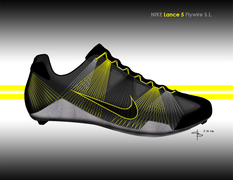

Here is what I envision as the Lance 5 cycling shoe incorporating NIKE’S new Flywire technology. This would be the lightest cycling shoe in the world. I developed two different versions. The rendering is of the SuperLight version and some of my other sketches have versions with a standard rachet buckle which would be the other slightly heavier version.
All comments welcome, thanks for looking.
Nice to see the sketches behind the idea. Here is one suggestion I have for you (and anyone else who is inspired by the new FlyWire technology and is using it in their designs) >> try to think up new patterns for the FlyWire instead of using the criss-cross pattern already used on existing Nike product. Push the envelope a bit, think outside-the-box. How can we take this new filament technology and push it further, make its use better? It will make the concept a lot more refreshing and interesting, IMO. Nice improvements on your work though- keep it up.
ppadilla-I am working on one idea for a different use of Flywire. I am not sure how practical it is, or if it would work in the real world it is but it was just a thought. Stay tuned…
Never use laces on a high end cycling shoe. Ever.
Come up with a lighter buckle/velcro system instead. (carbon fiber?) The sole would be carbon, too, correct?
Also I’ve always found Nike’s cycling shoes to be a bit of a joke. They’re very uncomfortable unless you have very thin flat feet.
Sidi’s designs are much better on your feet, and this 6.6 is very light and stiff.

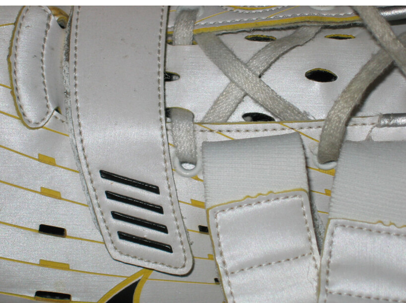

Nurb-I PUT eyelets in my cycling shoe because I think velcro sucks (looses its grip after awhile) and they work great!!! Don’t knock it till you’ve tried it. You can get the laces tighter than you think. Maybe more so than a buckle… Yes the sole is carbon. I have never used any other brand other than Nike and I do have thin flat feet. :slight_smile: Sidi’s are cool but I don’t like that the buckle is attached to the upper of the shoe, and they are so heavy. Unlike the Lance the whole heel cup is attached to the buckle so it pulls the bottom of the shoe up to your foot, much better in my opinion. Their carbon soles always look a little odd to me, doesn’t even look like carbon on some of the Sidi’s.

I still say laces are a bad idea. By the time velcro wears out (which on sidi’s seems like an eternity) its usually time to replace the shoe anyway. I sell both Nike and Sidi (along with Pearl and Lake) and I just sold a pair of the Dragon SRS shoes (from the ATB line up) to a guy who’d been riding the same pair of sidis for 10 years. He replaced the buckles a few times after they broke, and the velcro still worked fine. He finally broke the sole in one shoe, otherwise he’d still be on them.
Ask a racer or a hard core rider (150mi+/wk) about velcro, laces and the buckle.
Then ask a medium distance rider (50-149Mi/wk) about velcro, laces and the buckle.
Then ask an entry level rider (>50Mi/wk) about velcro, laces and the buckle.
you’ll be surprised by the answer…laces lose on all counts simply because velcro is inexpensive, easier to tighten and secure. Buckles don’t slip.
I think you do have a really good direction for a more casual or commuter shoe, but not in a high end race shoe. Race cleats tend to be super rigid to the point of preventing any foot flex or play for optimum power transfer. Commuter or low(er) ended shoes often have a need to be walked in so they need to be flexible both in adjustment of the upper and walkable, yet rigid enough to be efficient

Supernaut - those too would be hot if converted in to a cycling shoe! I went with the laces because that would be the lightest way to attach the shoe to your foot. As I stated in my first post I designed a buckle version too for those who prefer that, although they would be heavier. I am a medium/hard core rider according to your scale and I currently ride in the Poggio SL Limited Edition shoes as you can see from 2nd pic. I love them and modified them with eyelets because I felt the velcro didn’t hold my foot well enough. Eventually I plan on unstitching the velcro and adding a few more eyelets for lighter weight and better aero. I liked them so much I bought 2 pair so I thought I would tinker with one pair and see how a full lace shoe would work. Please post a pic of your old Sidi’s!!
Well there are exceptions to commonly accepted “rules”…nice job modding the cleats.
I cannot deny the buckle would be heavier, just wondering if its weight would be that much more noticeable. Especially for the added rigidity and security it provides across the top of the instep.
