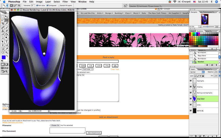

I recently went back and tried changing the color and the result was less than pretty. How can I get the shading to work with the change in color? Is this where channels would have come in handy?
It looks like you changed your “grey color” layer to blue, but the “shading” layer above it is still grey.
I’d recommend using an adjustment layer to change the color.

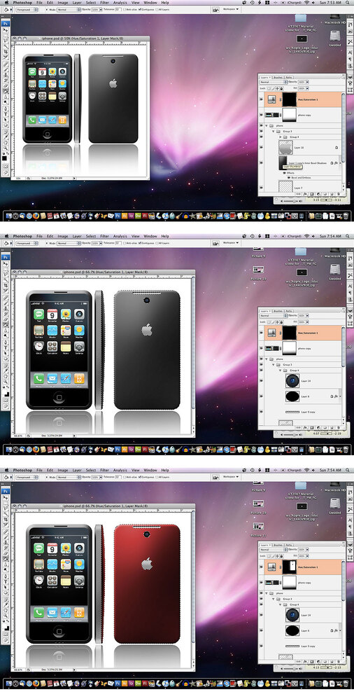

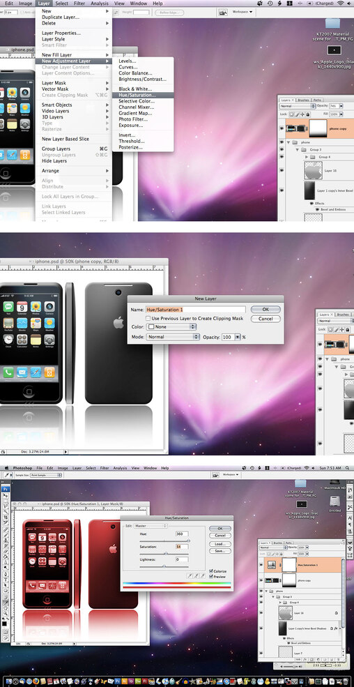

Here’s a quick tut for changing color, maybe others will find this helpful.
  1. Select Layers > New Adjustment Layer > Hue and Saturation…
  2. make sure “use previous layer as clipping mask” is unchecked, click OK
  3. Adjust the color with the slider- you can go back and edit this anytime
    (select colorize if necessary, experiment)
Masking
4. Make the adjustment layer mask black (hide). Click it and flood fill black, the color change should go away.
5. Create a selection around what you want to be changed (apple+shift click layer to add to selection, apple+option click layer to subtract from selection) in this example I selected the back housing, then subtracted the logo, camera, and flash bar.
6. Select the adjustment layer mask, and flood fill your selection white.
You may need to play with the mask and the layering to only change what you want.
Masking
