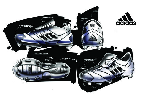

tried the blue-ish style out…those are hot.
15 mins before bed.
thanks for looking,
david
Nice!..Good to do quick little sketches like that. Keep it up and continually work on those proportions and views. So are you using a wacom and painter then?
I personally really like your sketching and feel compelled to look at them. What i would like to see initially is how the shoe aids becks as a player firstly and then equal consideration to the aesthetic.
DB has a problem loosing his big toe nail and blisters on the tops of his toes (as do most pro players)
I’d suggest to go away from the tablet and keep on the side views for a while. I really find the sketch style overpowering any ounce of design intent in the drawings.
in the latest sketches above, i really cant see anything other than a few lines on the outsole sketch. crazy perspective angle too is making the communication difficult.
im all for loose sketches, but also believe in efficiency of communication. for the 10 minutes or so the sketches above probably took, you’d get across more in a 30 sec. pencil line sketch. In terms of process, exploration is always OK, but hopefully it gets you somewhere.
not trying to be too harsh, but trying to help. looks like you are falling in love with your drawings, but not really drawing anything from my view.
Rich hits it on the head…save the aesthetic once you have sorted out how the shoe will work, construct together and so on. All the KG shoes i have seen reflect Becks as a person but not as an athlete on the field…be nice to see some ideas for ‘on the filed direction’
I do like the sketches though, would be nce if you could get the function working with the style, but again as Rich said…
i agree about the side views. i guess i just saw the cool blue style and wanted to try it. unfortunately, i do not have a scanner in my apt this summer. i packed light as i will be heading straight to europe for 4 months. i will try to scan some side view stuff after work one night.
as for falling in love with my sketches. just enjoy posting. it has been great to generate questions and comments and it is helping me out. i realize the more i continue to post, the more i will understand what is working and what is not working for me. i am sure the advice that is given to me can apply to many other designers…i hope they are reading.

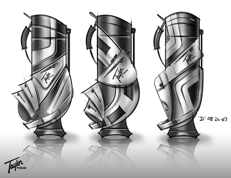

last quarter i did a co-op at a design firm in columbus, oh (priority designs). here we worked on taylor made golf products. i worked on some bags before…but i wanted to revisit them.
here is what i came up with over the weekend. late sat…finished up sunday morning upon waking.
thanks for looking,
david
