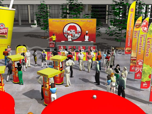

My company is looking at getting a 3d rendering program and i need some advice on which one was used by our vendors and freelancers. We have emailed a few of them and asked but never gotten a response. It looks like CAD to me but i am not 100%. I am attaching images of one of the old jobs we did and the rendering we got from them. Thanks for any help you guys can give
It looks like either AutoCAD 30 or 3DS max. The models have a very geometric shape to them so I would most likely say that it was a solid modeler rather than a nurb modeler. Also 3DS Max is used for a lot of Architectural renderings but the 3D forms are sometimes created in Auto CAD. I hope that helps.
well…
It could be a lot of things…the problem with identifying this is that its such a basic render, not a lot of advanced technologies like GI, radiosity, sun system, HDRI etc.
Many of the rendering engines have a style or signature that an experienced eye can pick up on, but this one is hard.
Could be 3dsmax (or Vis)…maya…autocad…xsi…rhino…etc etc.
If I had to guess…I’m going with 3dsMax with the scanline renderer.
(That patio texture looks like an older 3dsMax default texture)
The people are from Poser.

I didn’t even know AutoCAD had a renderer. Weird. If you only need renders that are of the quality you show, there are many options.

Answer C: Polygons, not solids or nurbs.
There is no way to tell precisely what software that was made in. Thats like asking someone to pick up a piece of plastic and tell you what country the factory was in.
Either way theres no advanced features used, but that doesn’t mean it couldn’t have been done in Mental ray with all the advanced features turned off.
We are looking for a the type of images i posted above and dont think at this time we will need more realistic ones.(like maya type stuff) The images are for clients so that they can get a basic feel and look of what things will look like in situation.

MAX is my bet.

rendering done in Sketchup?..
